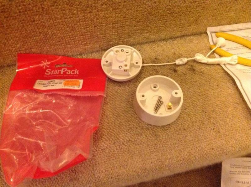

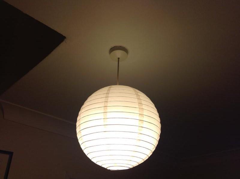

I am attempting my first electrics project for a dartboard spot in my hallway.
I want to run a 3 light spot from my hallway light with a pull cord next to the spotlight. I have purchased a pull cord but spotted it is described as a one way, can I use this? The idea is to run a cable along the ceiling from the hallway light to the pull cord and then a cable to the spotlight.
Any tips for doing the job or another way of thinking would be appreciated, many thanks.
"One Way" means it's just a simple on/off switch which is probably what you want.
As opposed to "Two Way" which would switch one circuit on at the same time as it switches another one off (also called "change over"). Used in homes where you want two switches to control the same light.

I understand. What is the difference between the common, the L1 & L2 on the pull cord switch?
On a two way switch, L1 and L2 are the two outputs. So with switch in one position C connects to L1, in the other position it connects C to L2.

So here is the thing that I haven't quite grasped yet. If I run cable from the ceiling rose to a pull cord and then to the spotlight, how does the neutral connect? Live goes through the com to L1 then to Live connector in the spot and Neutral comes back but how does it connect in the pull cord so it can go back to terminal 8 in the ceiling rose?

You buy a seperate terminal block
Or choc block to connect the neutrals.
Regarding the earths there maybe a terminal in the back off the backbox to join them. If not, again use a seperate terminal block

Assuming there's enough room in your pull switch, join the in/out Neutrals with a bit of connector strip. That's perfectly OK just sitting inside the switch housing as long as there's no bare copper showing.
IMPORTANT - your light fitting is metal, so you need to connect the earth as well. In fact it's more important at the light fitting than at the switch.
