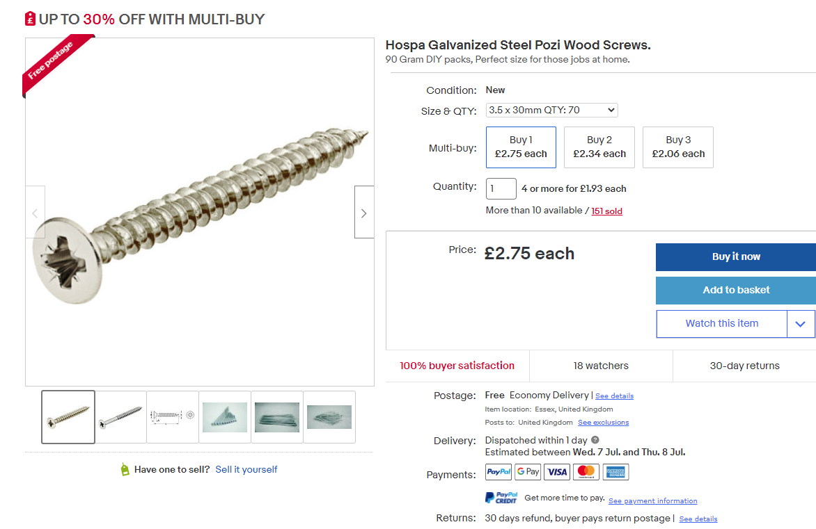

What size you use of these Hospa screw? Do you have to countersunk or they automatically goes in without chipping?
Hospa screws generally drive quite cleanly without piloting. To join carcasses you'd need something like 3.5 x 30 or 4.0 x 30mm. Position them where they cannot be seen - two beneath the hinge cruciform plates, for example, maybe one at the rear of the carcase near the top (where you'd need to be 3ft high or double jointed to ever see it), etc. Then it doesn't matter if you get a little bit of chipping. Drive them fully flush, but don't leave them proud, or drive them too far under the surface, either. You can buy them of eBay these days. If you can't get them a high grade BZP screw such as Spax or Reisser is the next choice
You mean this ones?

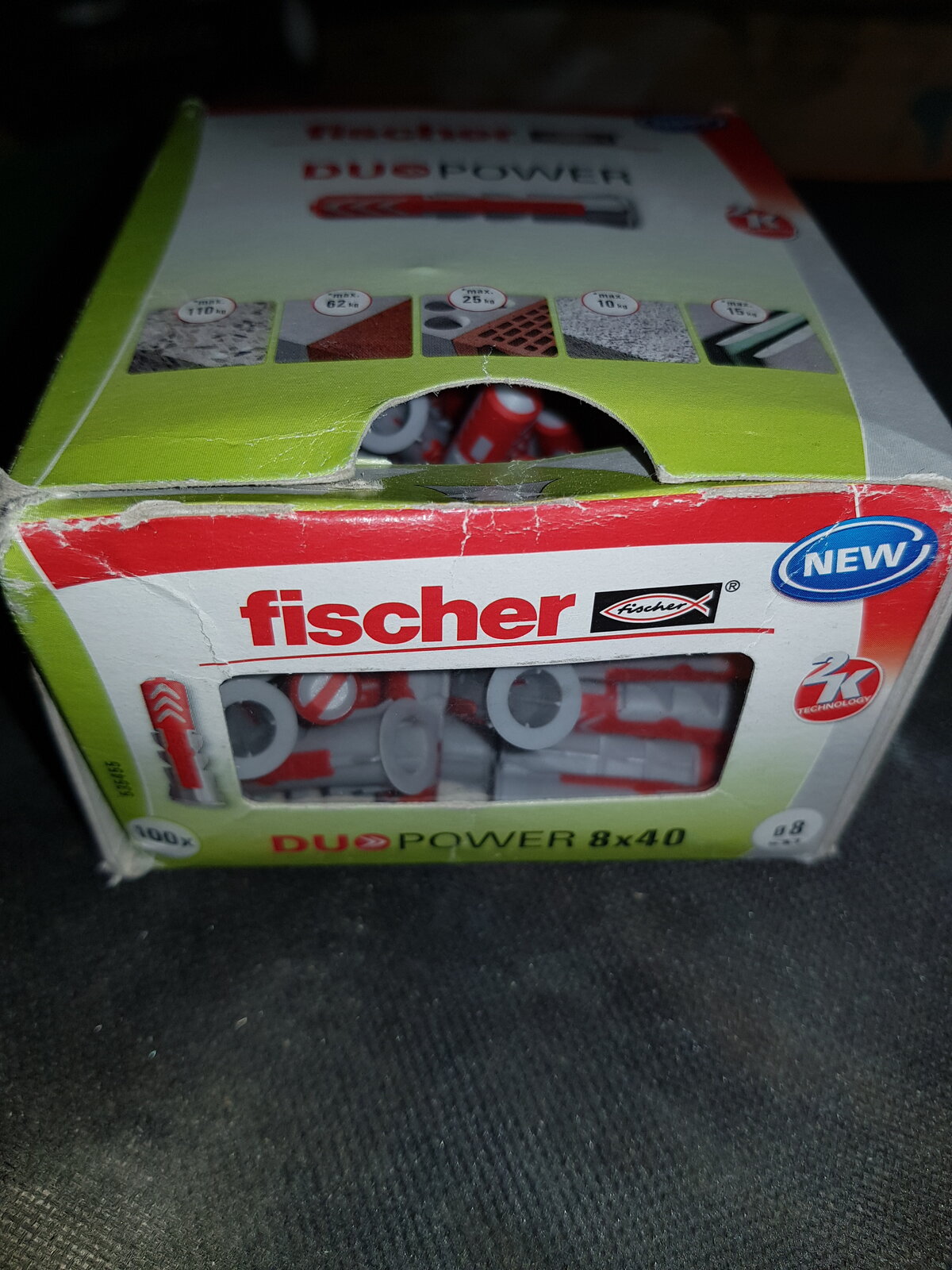

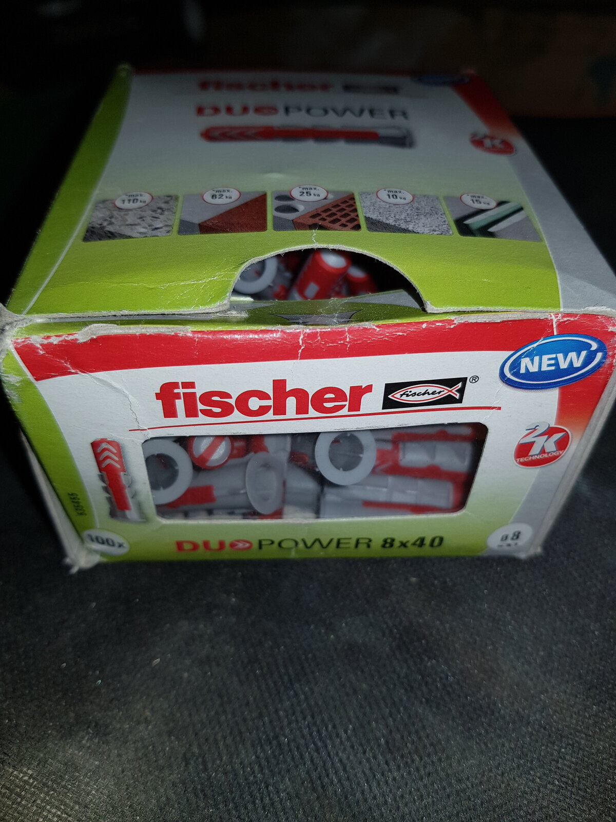

What plug size would you use on single brickwork partition wall?
I almost invariably use Plasplugs Brown 7x40mm, and buy them by the truckload
I admit that in many cases this is overkill, but it saves me the trouble of keeping handfuls of different ones.
Very rarely I need a longer or wider one for a particular reason.
I don't do it for a living.
J&K is an expert.
I now only use duopower fischer.
8mm for wall cabinets.
I have a box of this. Are we talking about same plug? What screw you normally use? 5x50mm are okay?
Yes.
Then of course i adapt the lenght of screws accordingly to what I'm sticking on the wall.
Ideally the screw should protrude 10mm from the end of the plug.
So your 50mm is perfect for the wall brackets which are only 2mm.
