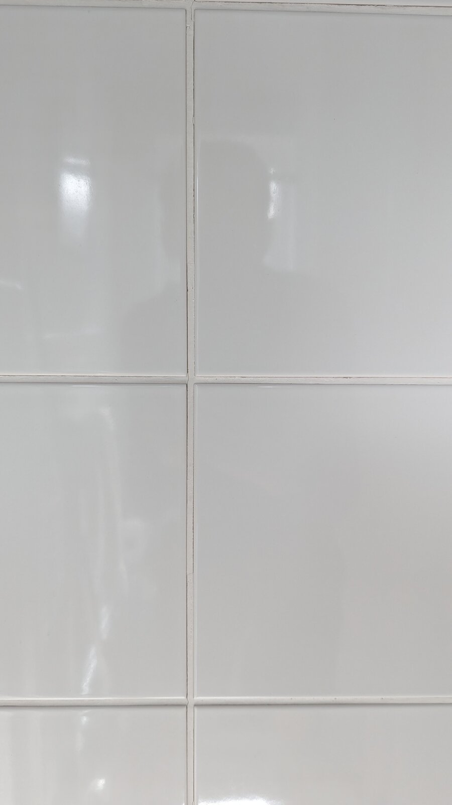

I've attached a pic to help. Taken note of the above, thank you

Thanks I was a bit concerned when reading that power based grouts are not waterproof but it would make no sense being the case for shower grouts..
As you can see I only need a smallish amount for grouting in-between the tiles. What would you go for as I will get some tomorrow.
