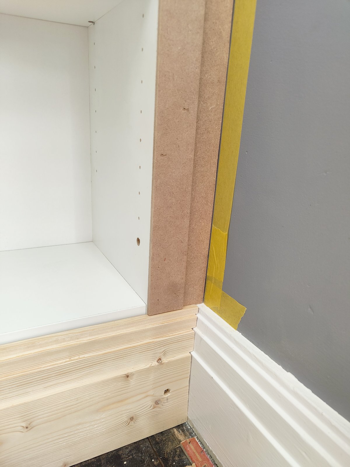

Screw a leveled off 4x2 frame to the floor, and stick your IKEA/kitchen carcasses onto that.
If you've got a small gap at either end due to the off-the-shelf boxes not quite filling the full space, don't forget to fix a batten to the side of the carcass, gives you something to screw/glue a side trim panel to.
You can either run skirting up to it as Freddie has done, or let the carcasses overhang a little bit and fit a plinthy thing underneath.
Second option prevents stubbed toes, makes the room looks a tiny bit bigger, and saves you having to scribe in the skirting.

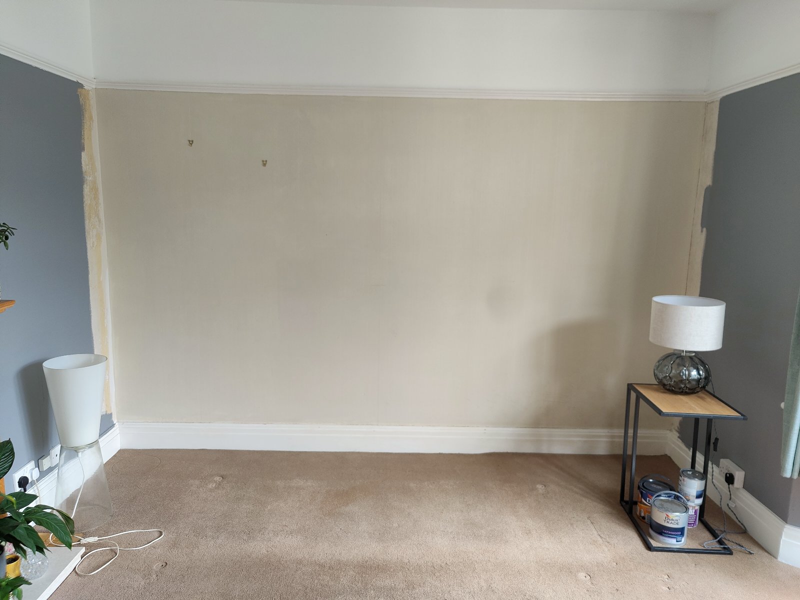

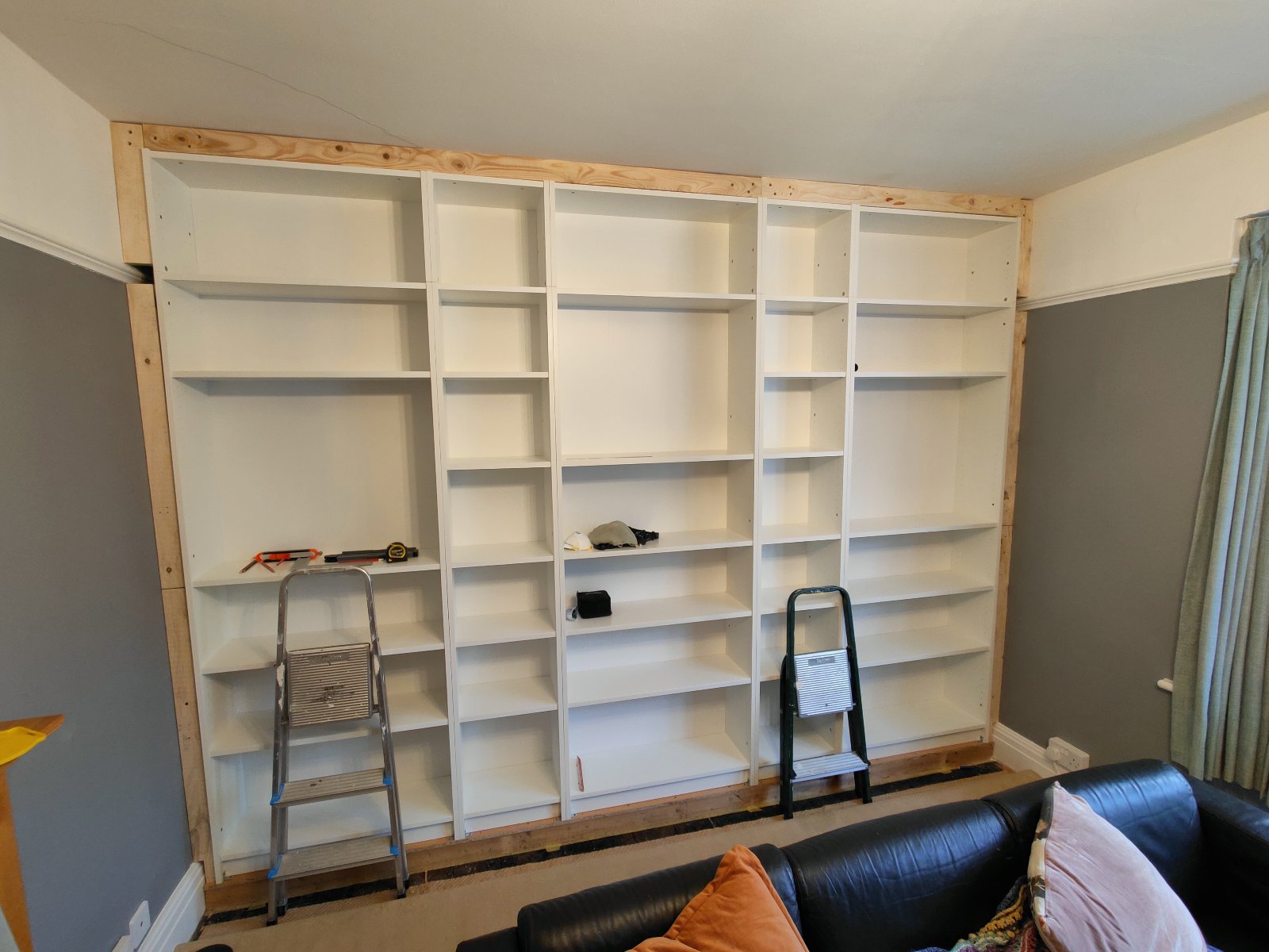

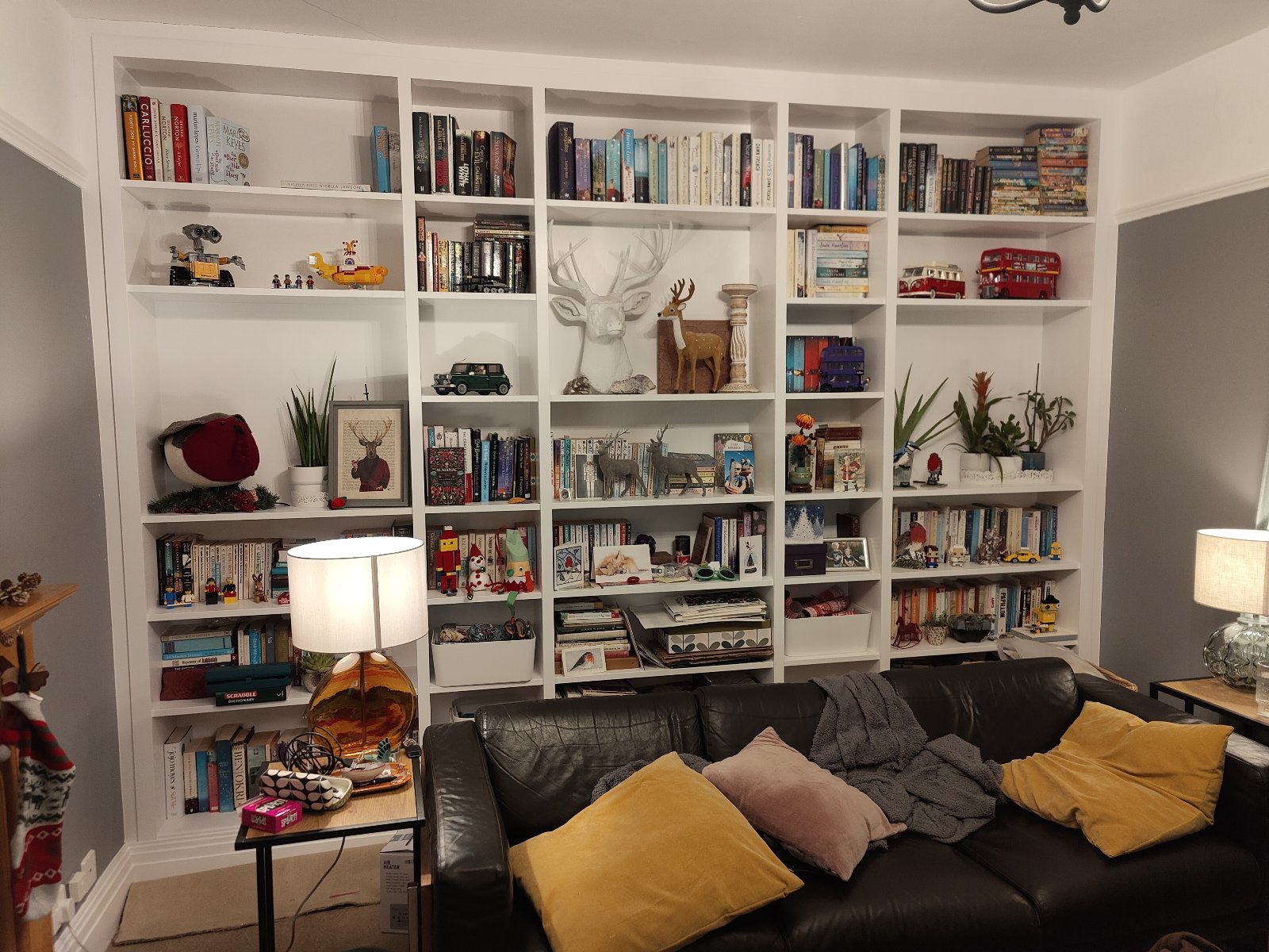

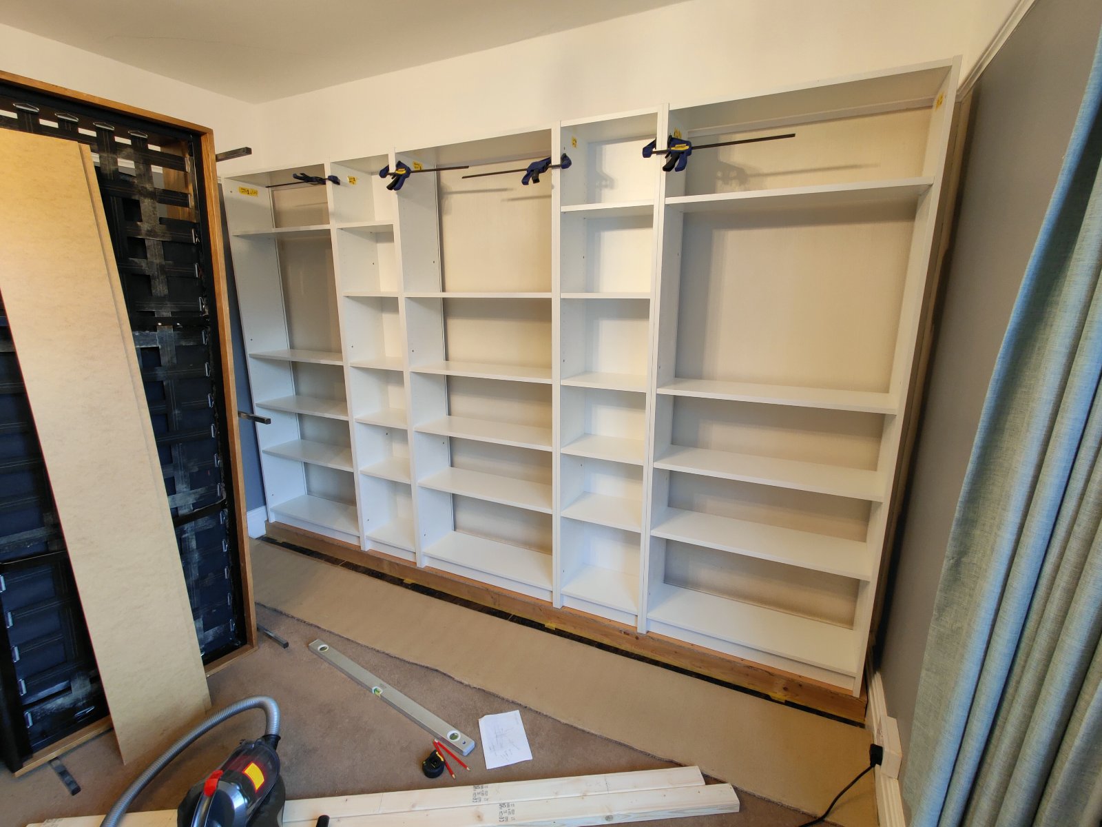

I extended my Billy's with the standard extensions, by total luck (as seen in the pics) the wall space available lent itself to the Billy dimensions perfectly.

I would add that there was a lot of strengthening work done to the standard units before they were built in, absolutely no sag etc and when you tap any of it it it's got that solid sound rather than a standard Billy which frankly is a bit crap!

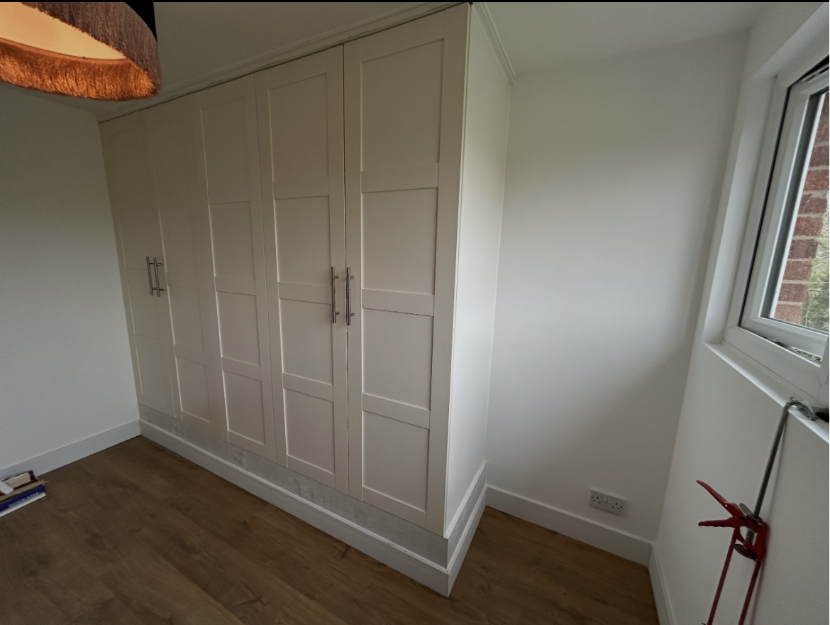

All done, 4x 10 year old ikea pax 500mm wardrobes and one new one. Just needs new handles and painting. They love it, Thanks again for the pointers.
