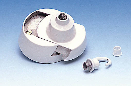

I have looked at fitting ceiling roses many times, the regulations say they should take a weight of 5 kg, I would not like the test that, seen many fitted to plaster board, in the main 9 connectors, 3 permanent line, 3 neutral, 2 switched line, and a clamp for all the earth wires, that is a lot of wires to connect in a small space above your head, specially holding a chandelier as well. As already said common to find a black or blue is line not neutral, I fitted these 1684749327378.png so in the future I can wire the lights on the floor, and simply plug them in.
It also meant no weight I need to hold above my head, and with the number of threads where people can't get new light working, it seems people have a problem with ceiling roses. And seems you have already engaged an electrician, so would still need to pay a cancellation fee, so would not save you £70.
