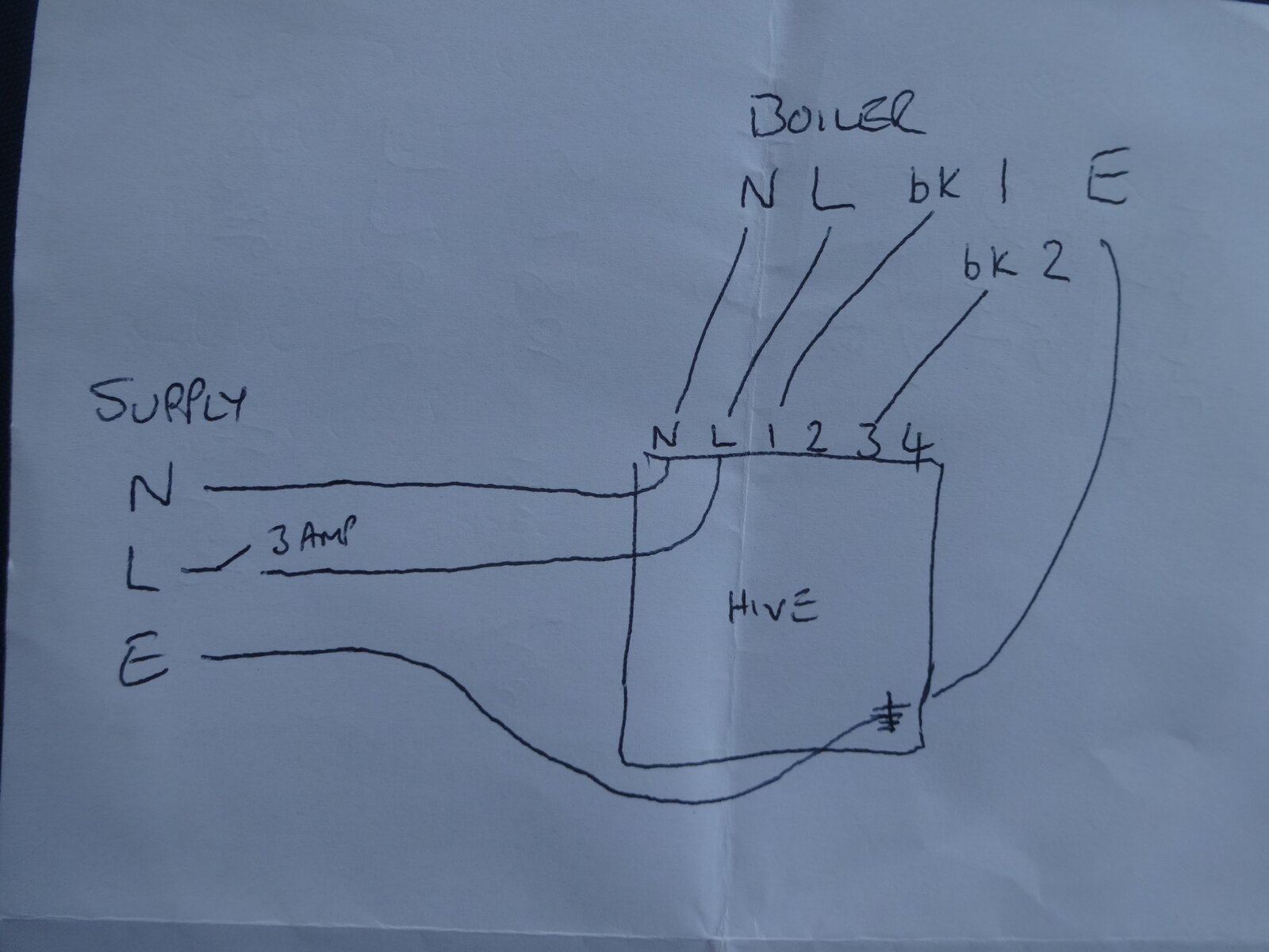

Hi I am wanting to fit a single channel Hive to a Baxi combi. The wiring diagram from the service manual is shown below. If i wire it up as the drawn sketch attached underneath, will this work and be correct?
Theoretically.....
....Yes! :)
If I was being ultra fussy, I would say the live feed from the boiler is on bk2, so that should connect to common on Hive (pin 1).
But that really doesn't matter in the slightest; the outcome will be the same! :)
