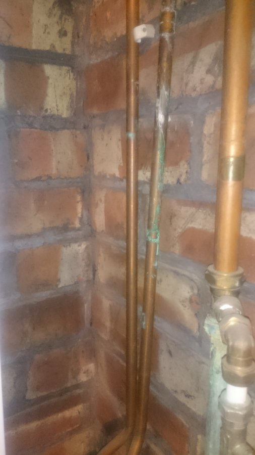

Give us a pic of your proposed supply pipe - typically you need to cut a 10mm piece of pipe away to get the tee in, but it isn't always necessary.

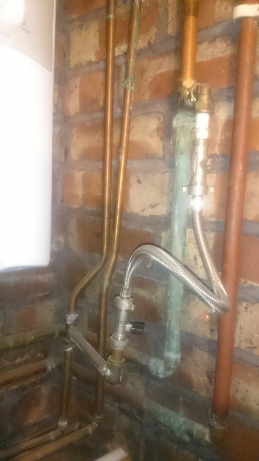

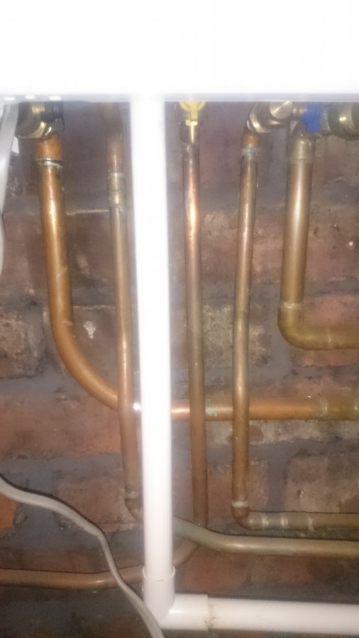

That left hand one is the cold into the boiler.
It's the fourth copper along there.
Just been looking at this, but that flexipipe hose goes from the cold water (into boiler), into the return pipe for the central heating, with the little switch valve. Could I just unscrew that and screw in a tap?
No, that's the boiler filling loop....but you could break into it's supply pipe - only one cut needed, insert the tee, add a short piece of pipe to the open bit and fit a washer tap valve to that.
John :)
Or you could remove the compression elbow just before fill loop valve and replace that with a compression tee. But it really depends where in relationship the WM is going to be located to the pipework?
Consider clipping the pipe to the wall too.....machine valves close quickly which is likely to cause a clunk every time.
