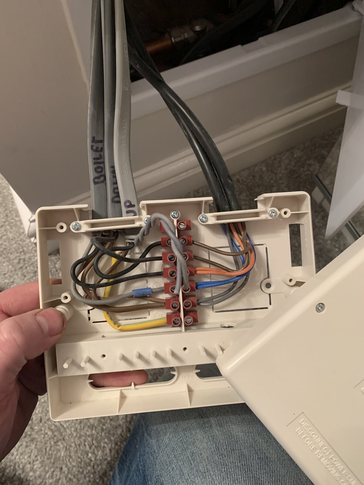

Hi guys I wonder if you could help me I’ve fitted a hive thermostat to my boiler and it worked fine the boiler was turning on and off fine but the radiators didn’t get warm then in a cupboard I found what I assume are radiator valves they are wired as in the photograph I’ve attached,do these valves have to be removed now I’m using a different thermostat controller??? Thank you very much for your time

That looks like an S-Plan system with two motorised valves connected to it [black cables]. Do you have upstairs and downstairs zones?
In which case the Hive should be wired to the Zone valve, not directly to the boiler. The Hive needs to open the valve and then the valve starts the boiler.
If the valves don't open, the radiators won't get hot.
If you do have two heating valves you will need to Hives

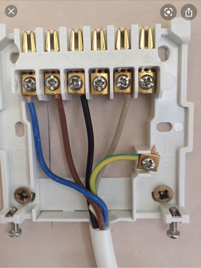

Good afternoon thank you for your help yes I have 2 thermostats at the moment. I bought 2 receivers and two controllers I looked at installing videos and it looked pretty simple. I’ve just moved into the property so found the two valves by chance in a void above the stairs. Would it be possible to find a wiring diagram as to where I need to fit which cables to which port as there are quite a lot in the existing block I’ve attached a photograph of the hive receiver block thanks again for your and trying to help me

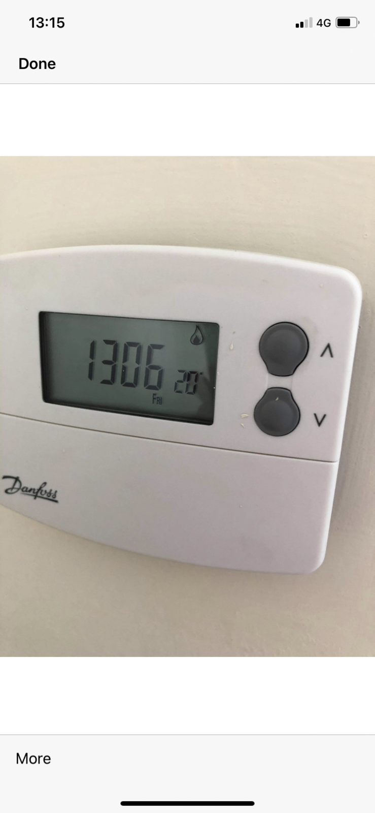

The wires that go to the existing thermostats need to be rerouted to the Hive Receivers. What make/model are the existing room thermostats?

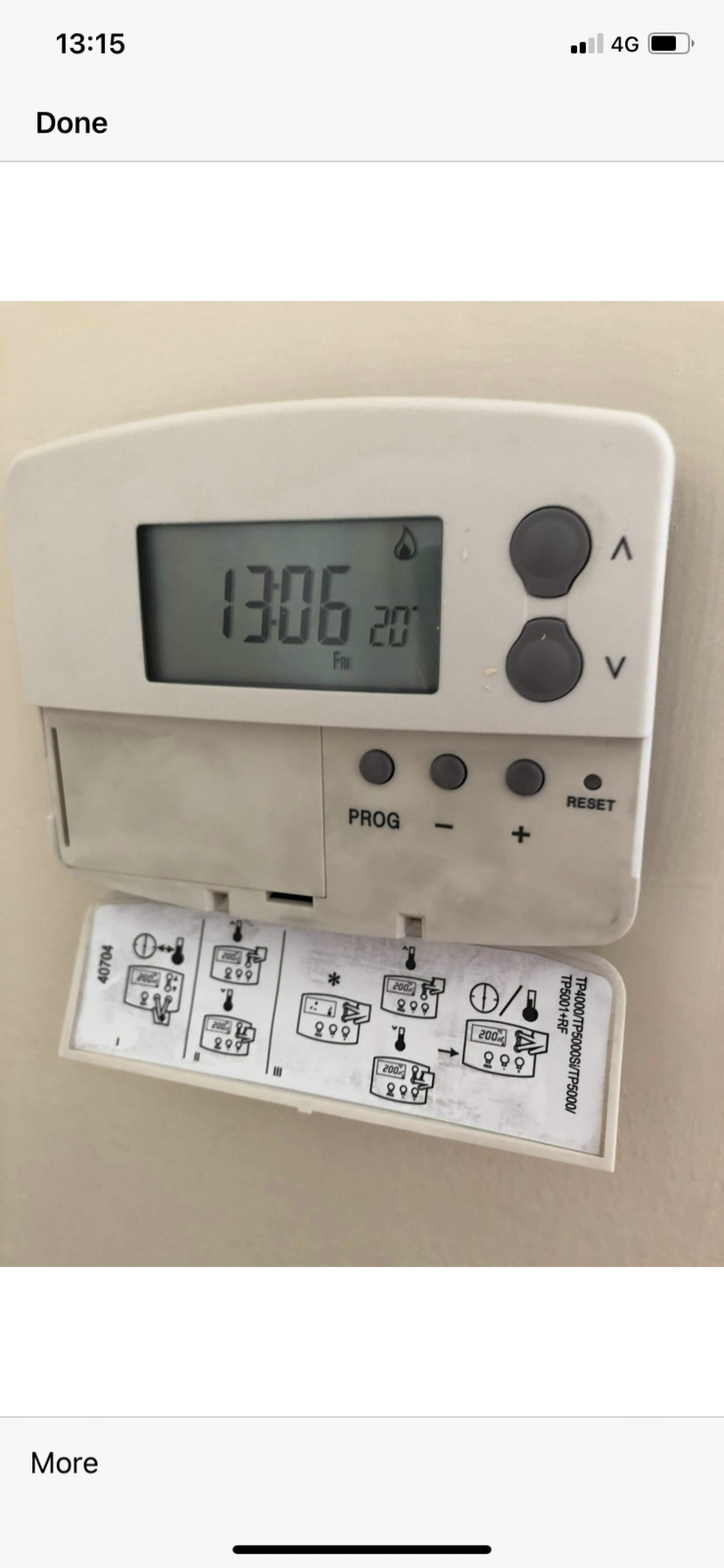

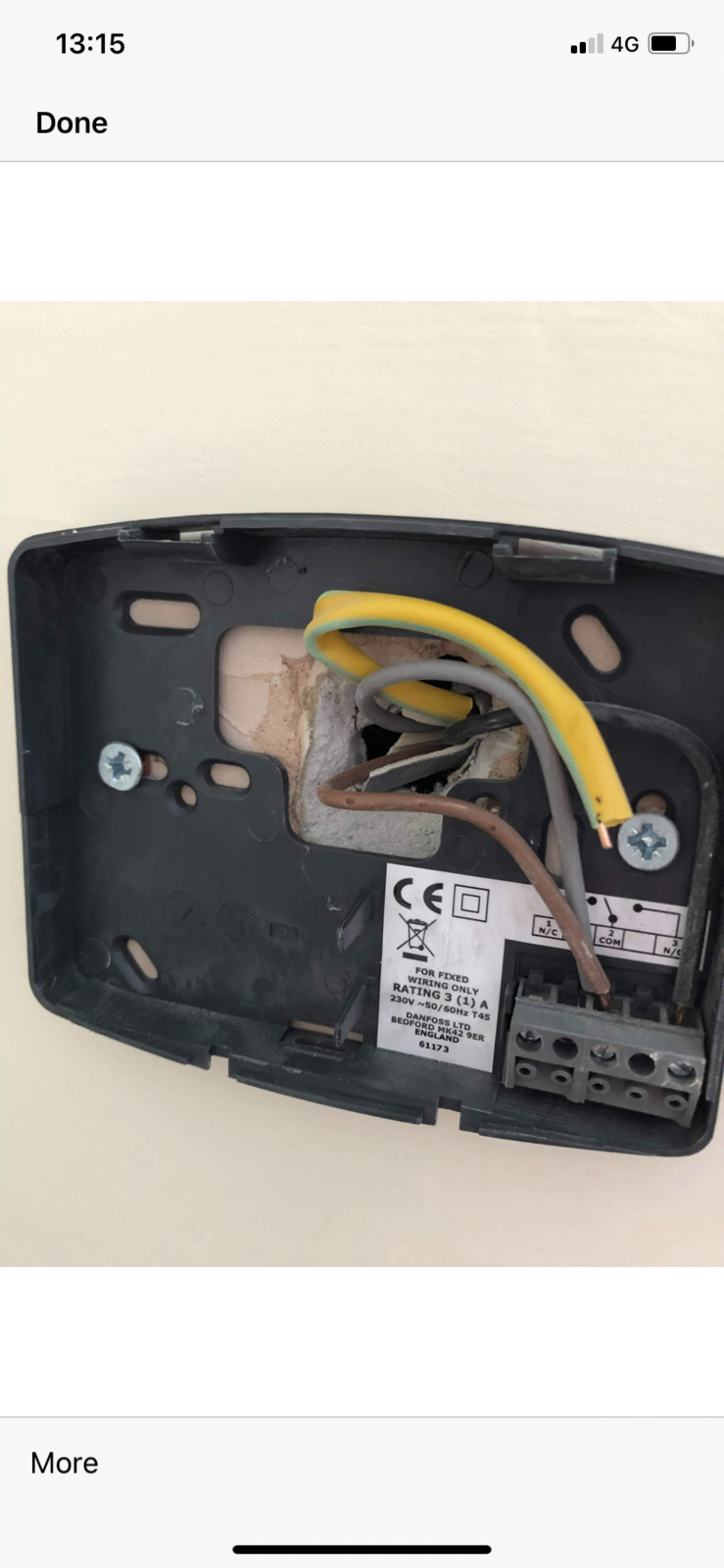

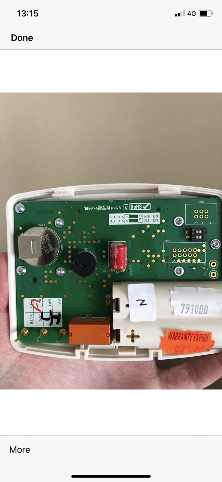

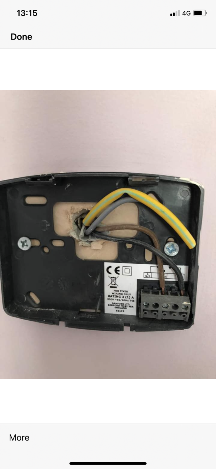

Hi there these are my existing controllers I have one in living one in the bedroom thank you
scott

The wires from the existing thermostats go to the Hive terminals that are marked the same. So:
Wire in thermostat COM = Hive (1) Common
Wire in thermostat NO = Hive (3) Heating call for Heat NO
You can move the wires presently going to the existing thermostat to the Hive receivers; or disconnect the thermostat wires from the wiring centre and install new ones to the Hives directly. Perhaps locating the Hive receivers next to the wiring centre for convenience.
The existing Danfoss thermostats are battery powered so don’t have a mains supply, but the Hive receivers are mains powered so will need a 230V supply connecting to N & L. This should come from the same 3A fused spur that provides power to the rest of the heating system.

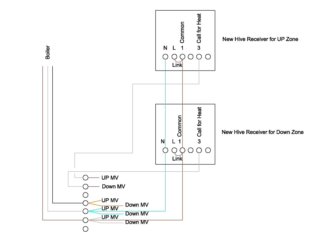

That’s brilliant thank you very much can I just ask the grey cables marked up and down have a black cable are those no longer required wiring the receivers as you’ve shown I really appreciate all you help
I assume that you mean these.
They are the live supply to the motorised valve microswitches. They need to remain in place. The micro switches are connected to the grey and orange wires. When the valve opens the microswitches operate and start the boiler. Don't confuse them with the grey wires from the room thermostats that weren't connected.
UP MV = the wires in the black sheath that go to the UP motorised valve. They don't change leave them as they are.
DOWN MV = the wires in the black sheath that go to the DOWN motorised valve. They don't change leave them as they are.
So in summary the wires in the right hand side of the terminals don't change.
The cables marked UP and Down on the left hand side are removed. They go to the existing room thermostats.
Perhaps if I redraw the diagram slightly it will clarify. Electrically it hasn't changed but the wires are located on the side of the terminals they are physically connected to.
