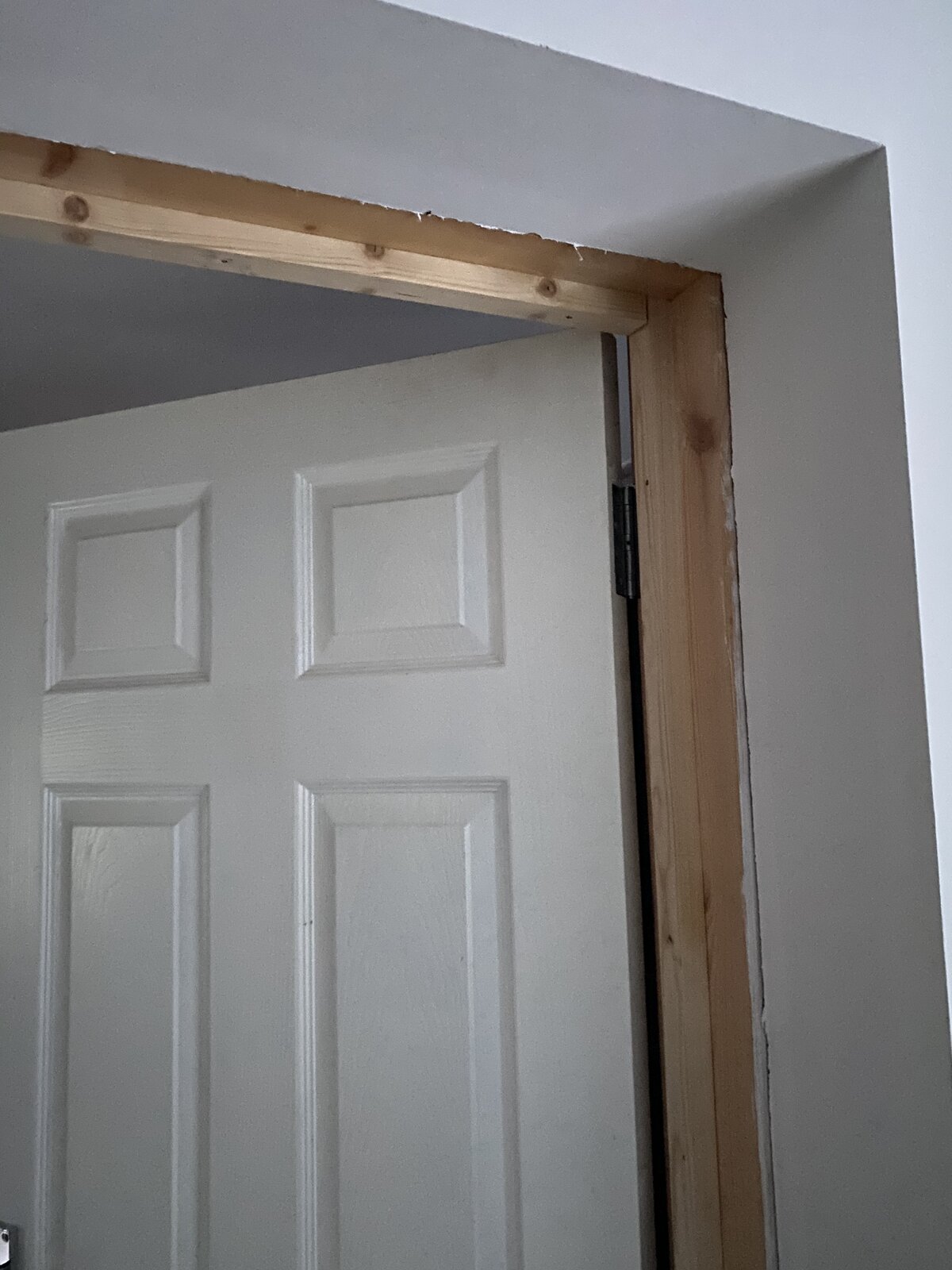

If the door is to be hinged on the inside wall, but opens towards garage, won't the hinges be the wrong way round? Also does it pose an issue with door fitment / clearance?
Why can’t you fit the hinges on the side closest to the garage and keep everything else the same?
Like this
Fit the lining on the hallway side, and hinge it on the side of the lining closer to the garage, and fit an architrave on the hall side.
