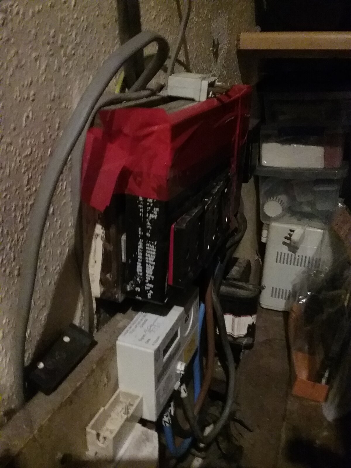

Not happening at mine for a while. Fook that.View attachment 200554

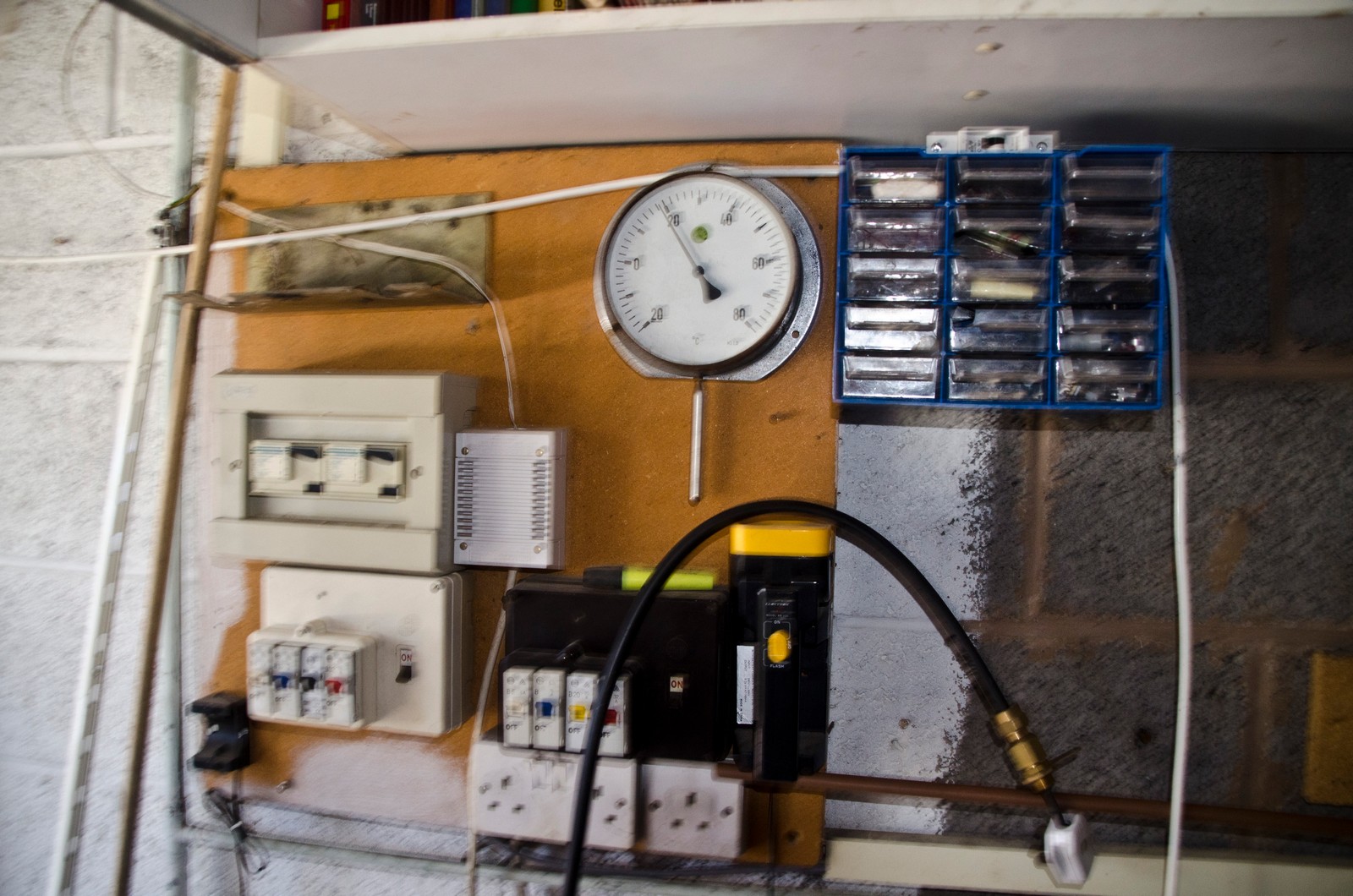

My old house also has the old Wilex boards two of them with two RCD's feeding the whole board. DSC_3921.jpg just because it has an old Wilex fuse board that does not mean no RCD protection, those went in around 1992 so over 25 years, and they are that old not marked as to what type they are, which clearly causes another problem, if not marked how could anyone advise the customer?
I would say as a Plumber one only expects level 3 qualifications so can't see a court blaming the plumber, but as an engineer as with heating and ventilating engineer one expects a level 5 qualification or above, otherwise should not call ones self an engineer, and I would think courts would expect anyone calling himself an engineer to know the installation was not suitable for the boiler.
