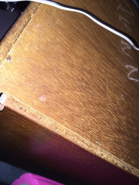

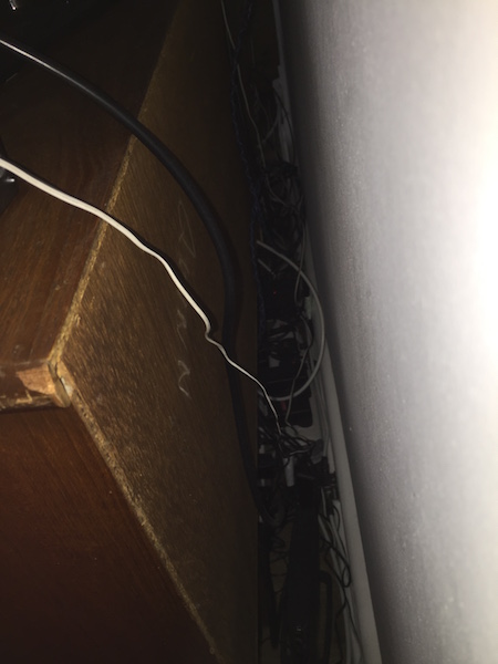

I have a 70s sideboard that I want to use a TV cabinet.
The back is currently plywood, but I'm thinking if I take the staples out holding it in place, I could then replace the back with pegboard and hide of the cables and guff at the back in a flexible modular way.
I need to add a bit of depth to the cabinet (currently it's 380mm deep) in order to fit a media computer in there which is 390mm deep. So I'm thinking of fitting the pegboard to the back with some sort of brackets attached to the inside of the unit. Then I'd have some extra clearence and additional airflow.
I've never really done any wood or furniture projects like this in the past. Are there any better ideas

Simpler to remove back and add a few vertical 100mm wide sections of mdf , drilled with holes to poke cable in , will leave the majority of the back open and still keep integrity of cupboard.[Removing the back will weaken the structure.]

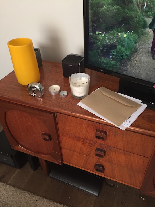

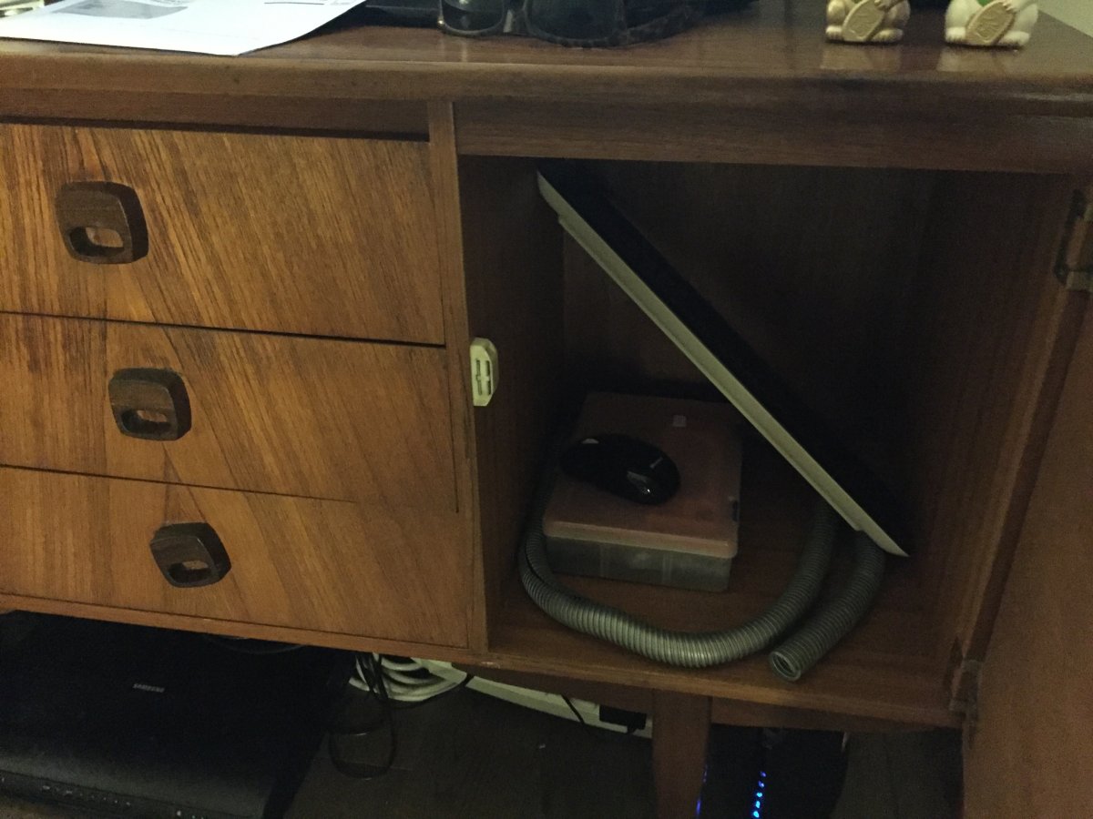

The unit is an existing piece. Picture attached showing the front which might help explain things better.
So really I can't add a new top to the unit. I can easily get to the back of the unit and don't plan on recabling it once it's finished. I plan to clip all the loose cables to the back. And anything big will go in the cupboards at the ends of the unit. Ie. Virgin Box, computer, Xbox.

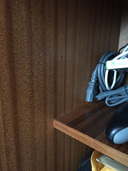

Would these be suitable to hold a sheet of pegboard 360 x 450mm? Am I fine to just screw directly into the pegboard? And ok to screw into the top / side of the cabinet. I think the cabinet is made of a chipboard like material with a top veneer... So should I pre-drill the acre holes first?
Based upon what foxhole said earlier, what I propose to do is remove the back panel completely and cut it down to just cover the back section where the draws are. This is to add some strength to the cabinet as a hole. And then have the pegboard at the back of the two cupboard sections. I've made a sketch to help illustrate, the green bits are where I plan to fit pegboard on the back of the unit, leaving a solid section of the existing back in the centre of the unit--laying flush with the surface of the top, bottom and sides. Is this a good ideas?

pegboard is only 3.2mm 1/8" thick so you need a frame to screw it to
you may get away with several brackets and cable ties or nuts and bolts but think you are over complicating the issue

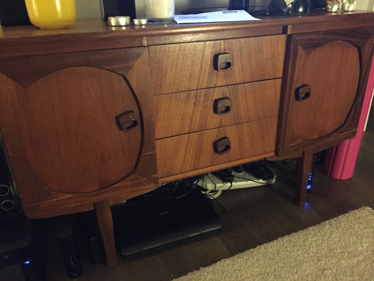

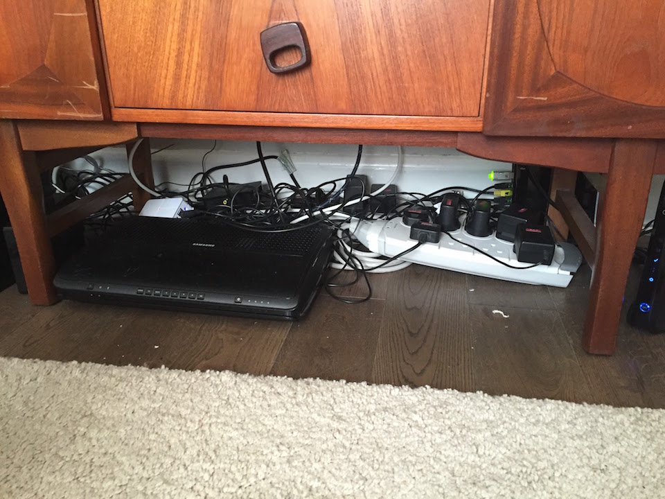

Yep, I'm trying to avoid the nest of tangled cables already under the cabinet (see attached photo).
The cabinet is already 40mm away from the wall so no issues there.

well as i say if you have the sockets at the top the mains lead will be mostly off the floor as it loops down then up
if you have say 6 cup hooks along the back you could loop the cable through as many as you need to lift individual cables or in groups with cable ties or elastic bands

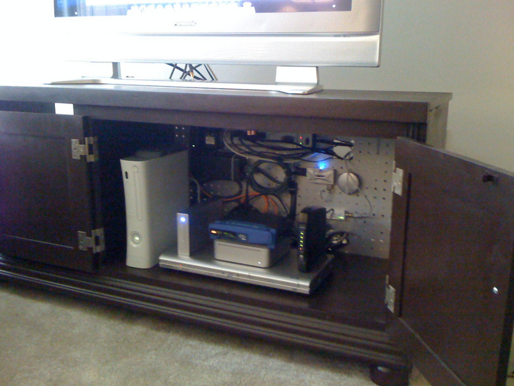

I've seen pegboard use for this sort of situation before and seemed to be quite effective. Just not sure how best to attach it to the cabinet once I've got the thin veneered plywood back off. Couple of links to images I found through Lifehacker.
https://www.flickr.com/photos/25376515@N03/sets/72157605651513410/

i assume you are only using the central section off the unit ??
if so just remove the back from that section and drill 4x10mm holes in a row top off the peg board[enlarge 4 holes]4mm x 30mm screws through these holes but sticking out 10mm and the board will hang on the heads to allow removal for access
