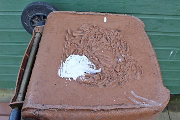

Can anyone suggest a filler to fix a hole in the bottom of a Garden Waste Wheelie BIn?
Someone was burning old documents and put the ashes in it some where still hot though even after 24 hrs.
I tried the Tetrion All Purpose Ready Mixed Filler 600g from Amazon but the weather has changed to cold and damp and it has not set.
I would need something thats water proof I think as it sits in a damp bay that does not get sun.
Any Suggestions? Thanks :)
You could glue some perspex over the hole. Using some like Stixall as an adhesive.
Its a sort of line not a regular hole though the picture makes it look much bigger due to the anount of filler I had to use. Where would I get Waterproof Perspex and the Glue thanks?
Perspex is waterproof. You only need a small bit, but I would recommend that you order a bit larger than the hole (ebay it). MS polymers such as Stixall are like decorating caulks, they will cure over wet surfaces and accommodate large gaps. You will however need a caulking gun to apply them.

Would it matter that its not quite level due to the heat warping?

A flat-tipped soldering iron and a rod of thermoplastic.
I used plasplugs to weld up cracks in mine

I would drop a perspex/plastic patch onto the inside and fix in place with one of the new polymers.
