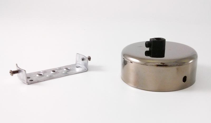

I have 3 x CFL ceiling lights on a new build flat (leasehold) but I dont like the colour temperature (4000K they provide). Looking to replace with incandescent bulbs with glass shade circa 1KG in weight. The ceiling is plasterboard - before I employ an electrician I need to understand if theres a ceiling joist they can screw into Ive heard the best way is to use a powerful magnet to search for the joists as the electronic ones are unreliable. Ive tried knocking on the ceiling but cannot hear a noticeable change in resonance. Ive also read on forums the ceiling may be 'false', be metal RSJs above or potentially concrete? Advice would be appreciated
Easiest way is to turn all the power off, drop the existing light down, and poke something through the hole in the ceiling and see what's there.
Unfortunately, nowadays on new builds, folk don't fit noggins where there isn't a nearby joist.
They just use plasterboard fixings, which can be carp.
Are you nuts? magnets are only interested in things with iron content. Ceiling joists are usually made of wood, so magnets aren't the answer.
I presume the idea is that a powerful magnet might help to locate the nails or screws attaching plasterboard to the joists. However, these days they are likely to be stainless steel screws, so a magnet probably wouldn't be of much use.

Yes correct the CFL lights right now have 4pin connections on and the new lights I want are ES incadescent.
Just had this back from the manufacturer:
"Weight of each light is 800g
If you are fixing these lights to plasterboard, then you would need plaster board screws and fittings"
This I found interesting - albeit its based around pictures on wall not lights on ceilings - but similar principal right?
http://www.todayshomeowner.com/testing-wall-anchors-and-picture-hangers/
It seems its a trade off between holding power and damage to the ceiling/wall.
Even at the lowest end of this test: 50lbs is 22KG - this light is nowhere near this level at 800g
So in summary just plasterboard screws should do the trick if theres no ceiling joist or similar to work with?
