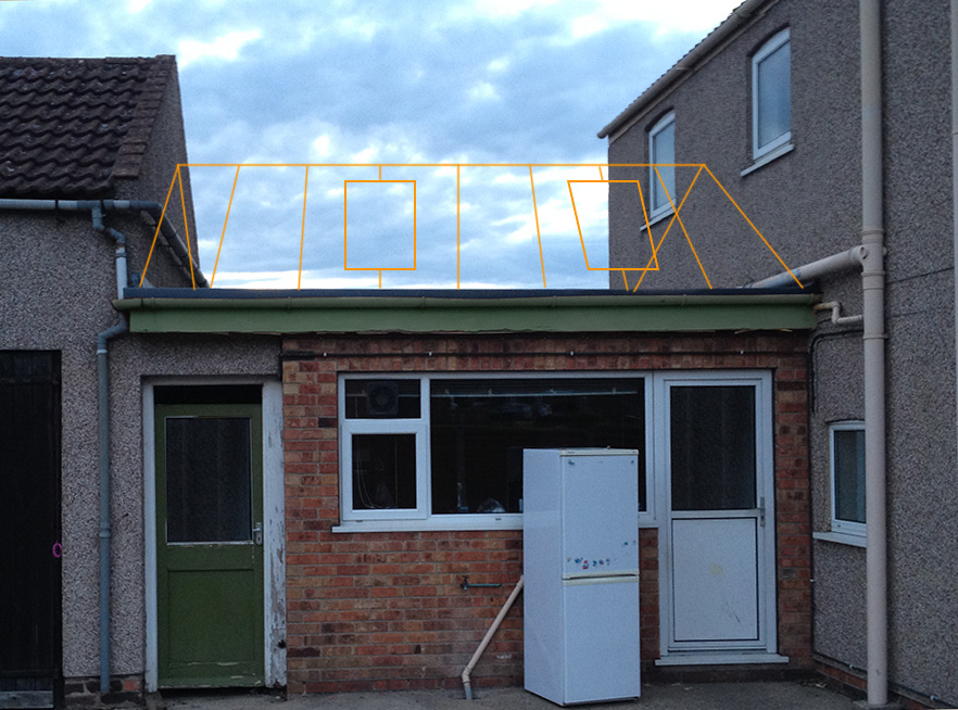

I'm looking at changing a flat roof (fibreglass) to a pitched roof and would like a little advice from you knowledgable types. The roof is on a single storey extension, (at back of house), that is sandwiched (at each gable end) between the house (on the right) and a brick store room to the left ... this store room is 5m tall with pitched roof at 30°.
I would like a raised collar type roof, preferably purlin free, if possible. With a couple of velux windows in, for added light. I'm trying to maximise head height. I would also like to use the same pitch angle as the store room.
The internal wall size is 4270mm wide x 4520mm deep, construction is double skin brick with cavity. Height to the ridge would be just under 4m.

Here's the idea, yes the furthermost window would be bricked-up to accommodate the roof.

Thank you for the photo.
If you lower the pitch there would be no need to brick up the window - esp as it appears to be a bathroom window?
There's no need for purlins. Ridge height is taken from the wall plate level. Total span is taken from the outside edge of the wall plates - the ridge is centred at half span.
Rafters trimming the Velux's need to be doubled.
Any new plumbing (soil & wastes etc.) and guttering arrangements would have to be designed in when the project design is settled.
Any work to be done above the roof should be done now before any changes below.
To commence you might be best advised to remove all the flat roof including ceiling, joists and fascias.
Do you intend any future knock-through on either side eg. into the main house?
Do you intend building up both gable walls and then having a structural ridge beam? In that case your rafter length is only going to be 3 metres max so I'm not sure why your builder is talking about purlins or making a fuss - you should be able to simply use 150mm x 50mm timbers and make a vaulted ceiling. Doubling up/trimming around your veluxes as you go. No need for collars either unless you particularly like the look.

650 centres ? what size batten were you using? .. 400-450 i'd say and as garyo says structural ridge,
A structural ridge is not necessary. A ridge board will do.
Dont pierce either of the gable walls with your ridge, simply pin your end rafters to the face of the walls. Sheathe the back of the rafters in wall contact with DPC.
No building up of any kind is necessary to support your ridge - thats what your common rafters are for.
Given the above sketch your 8m calculation to ridge height must have been taken from ground level to ridge. Take it from wall plate level.

For your purpose a sloping ceiling with 150mm x 50mm rafters will allow for insulation and the Velux's.

On a vaulted ceiling like that I'd want a structural ridge to prevent spread. You may well be able to do this by bolting the common rafters in to the wall at either end then using those to support the beam - calculations required.

Given the dimensions, and my suggestion, spread wouldn't be an issue - so why mention a non-issue?
