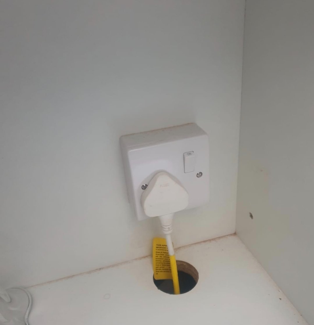

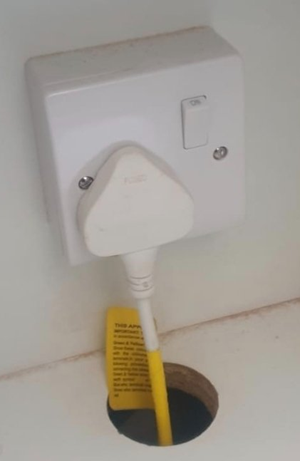

Floating sockets..
Thats how you do it, I've put one of those 50mm desk tidy things in since.
Its designed to be a portable extension lead not part of a fixed installation.....although it will work fine and is safe its not what its for so if came across it I would remove it and fix a proper back box and socket.
I'll go back to this. <134.1.1>
I think we're definitely going to have to 'agree to disagree' on this :-)
Just to make sure I'm not doing you an injustice ... are you saying that a trailing socket lying on the floor, wired with flex that went through a hole in a shelf to a plug that was plugged into a wall mounted socket would be 'acceptable', whereas it would not be acceptable if, rather than having a plug on it's end, the flex was 'hard-wired' into a wall-mounted FCU, switch, outlet plate, connector block/Wagos (behind blank plate) etc. etc. ... and that, given that you have cited 134.1.1, you would actually give a C3 to the latter?
Yes C3...
Whats 132.12 again?
No wrong one cant remember im out at the moment...
But still C3 yeah agree to disagree :giggle:
