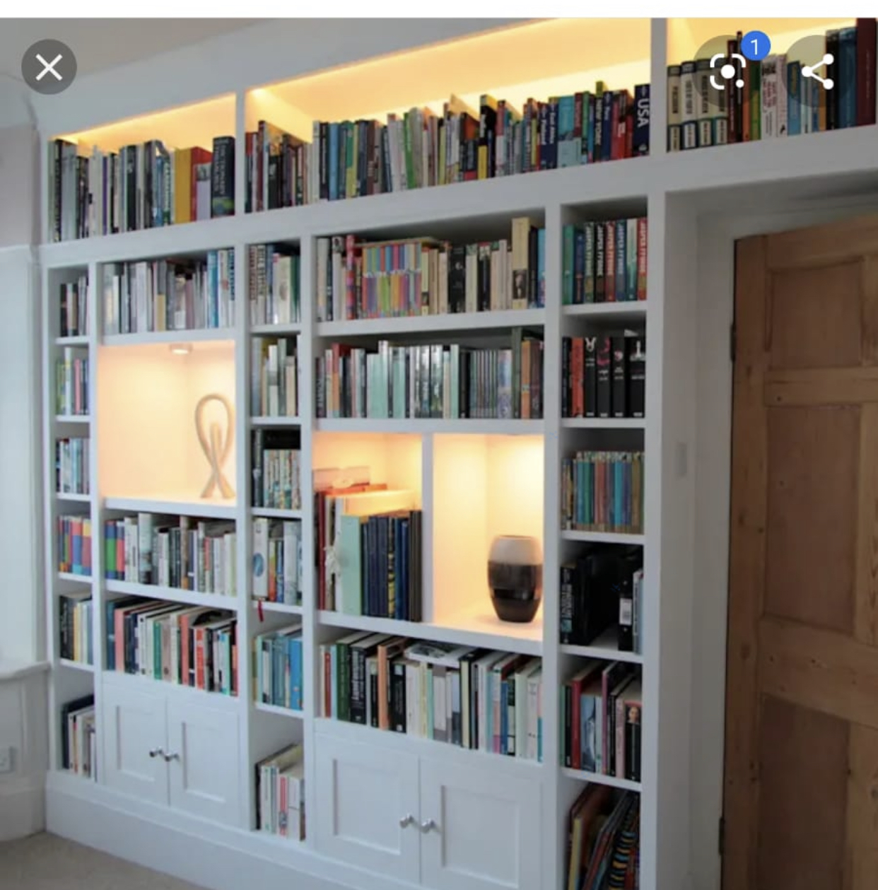

I have a wall which is approximately 2.3m high and 3m wide. I’d like to build a decent looking bookcase in this space and need your advice please.
This is the type of look I want to achieve. Less the doors.
Firstly which wood should I build this in? I want to eventually paint it white and be using a wood which will be easy to maintain i.e. if it gets damaged, I should be able to fill, sand and paint.
Also want to avoid expansion/contraction as much as possible.
Secondly, is it worth cutting shelves slightly short of the total depth available to allow light to flow from the top, down through all the shelves?
Thirdly, does this have trims stuck on the face of all the wood to create the wide aesthetic look?
Thanks in advance.

Looks like 18mm mdf structure, easy to assemble, trim to edges looks like more mdf strips around 50mm wide.
Very easy to add led strip lighting to rear of trims to illuminate the contents.

Dimensionally stable, prime and use short bristle roller for smooth finish.
18mm mdf , 12mm too thin for fixings and often more expensive than 18mm.

The detail of the execution of that is going to be the success or fail. With such a simple design the finish and execution has to be perfect or it will look like a bodgers build. To buy something like that would cost several £100's, so invest in some tools. If you are going to use painted MDF, then perhaps a track-saw for perfectly cut straight edges. Use dowels or biscuits to join the pieces together. Note how the pieces on the left have buttresses to stop the shelves all collapsing. A dowel jig at the very least will help you to line everything up. If you think about it, you can't rely on screws because many of the joints are not screwable. Horizontals have to rest on verticals - don't be tempted to butt horizontals to verticals and screw in from the side!
MDF needs a paint/sealer application which will raise the "grain" and then it needs sanding/wirewooling back before the final coat. I suggest you try and paint as much as you can before assembly. Perhaps consider a spray finish for the final coat. I'm sure other furniture makers will give more advice - I'm a better maker than painter...

Yes, glue and dowel as much as you can. Also looking at that design it's very clever - it looks random but the uprights are carefully positioned to spread the load. Obviously the uprights low down are taking all the weight of the higher levels. You will have to be careful you don't have uprights bearing on widely unsupported horizontals, or they will bend.
