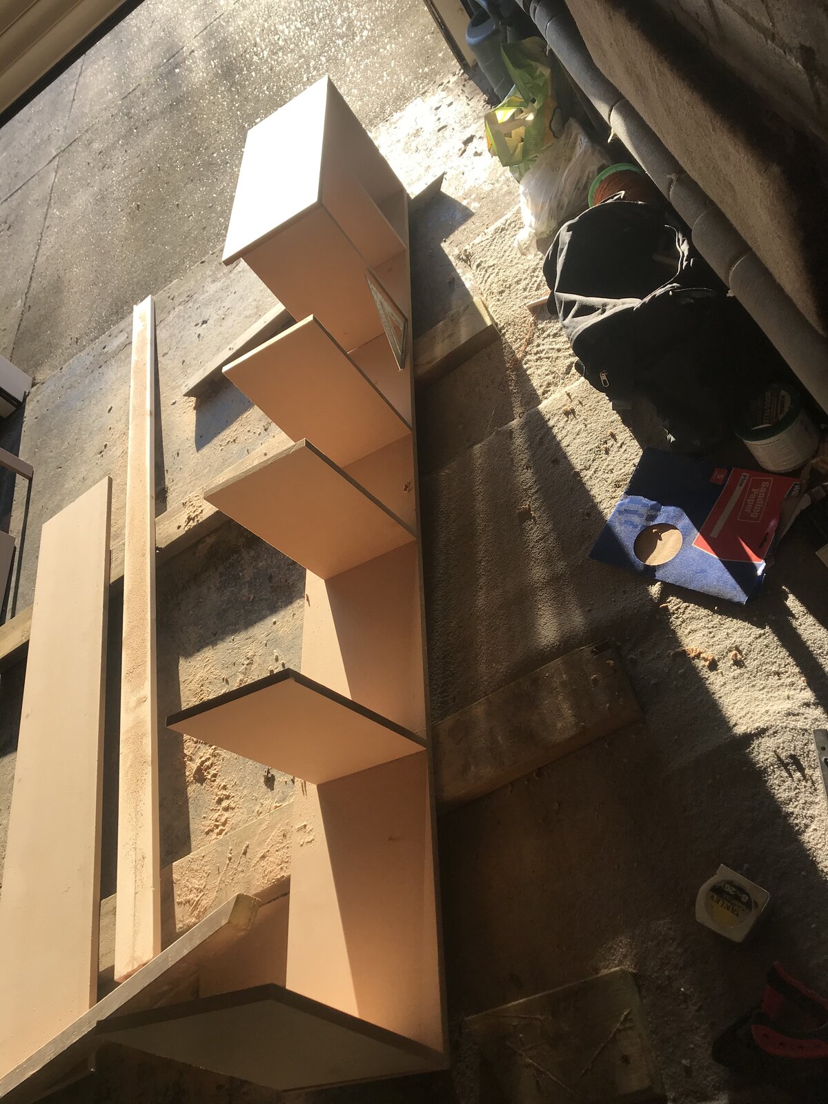

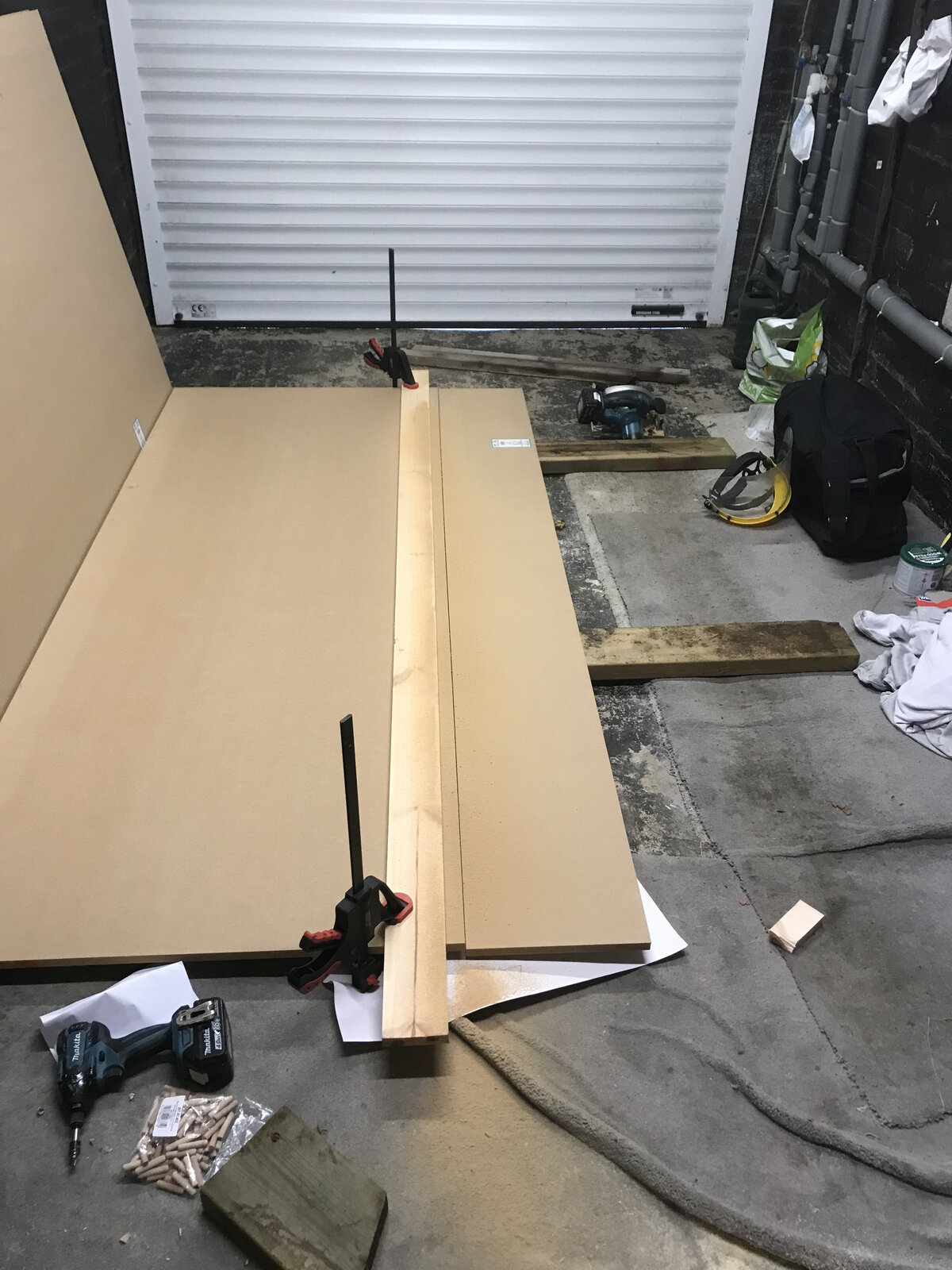

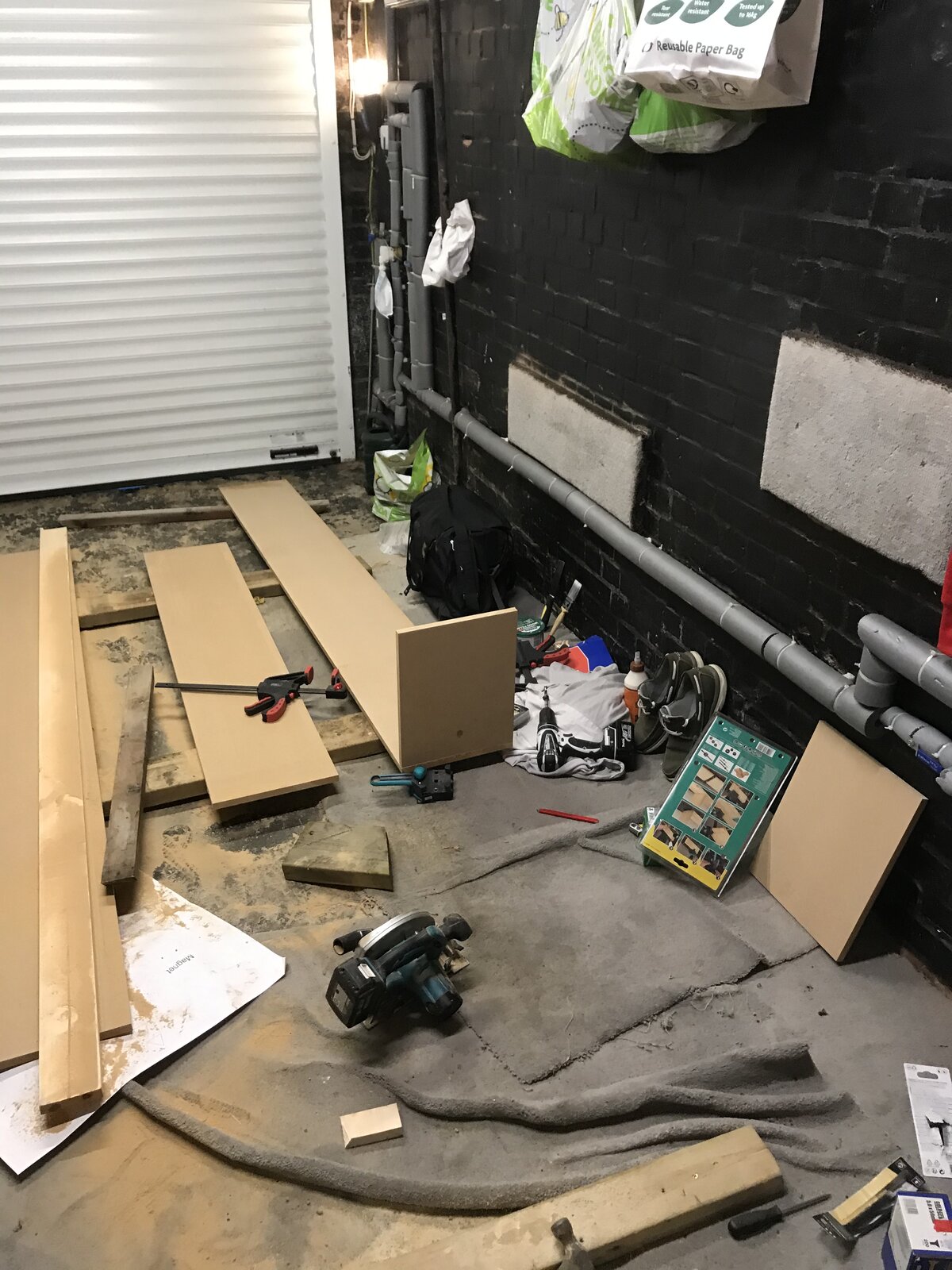

Thought I’d share some of my work in progress...
It’s been hard but enjoyable. Def not a walk in the park as I had thought from the outset. I’m hoping that now that I am getting use to the dowels and cutting, it should become easier.
I was planning to build a couple more layers whilst it’s in the garage and then move into the living room where I can build the rest of it in situ.
Please let me know if there are any other suggestions or flaw with my approach of wiring situ.
Thanks for your help
