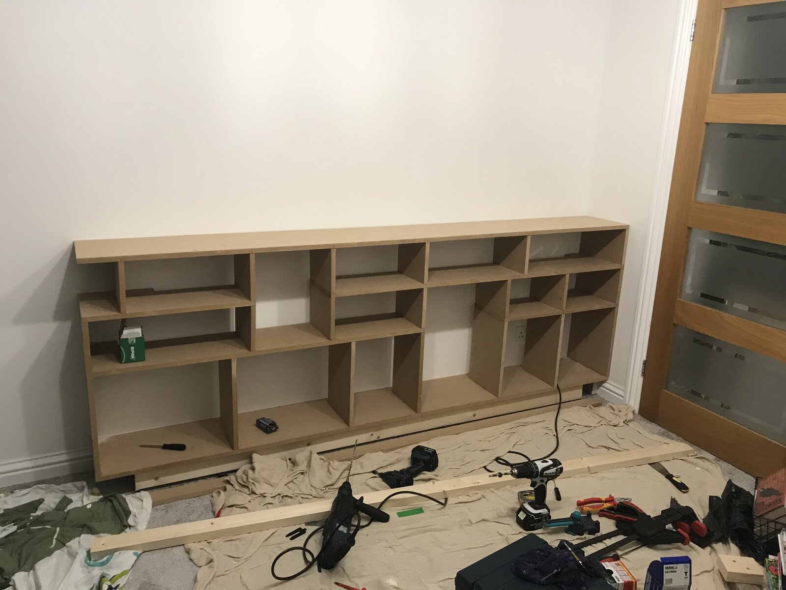

Hi Guys,
Another question on this project please. I am now reaching the half way point on this:

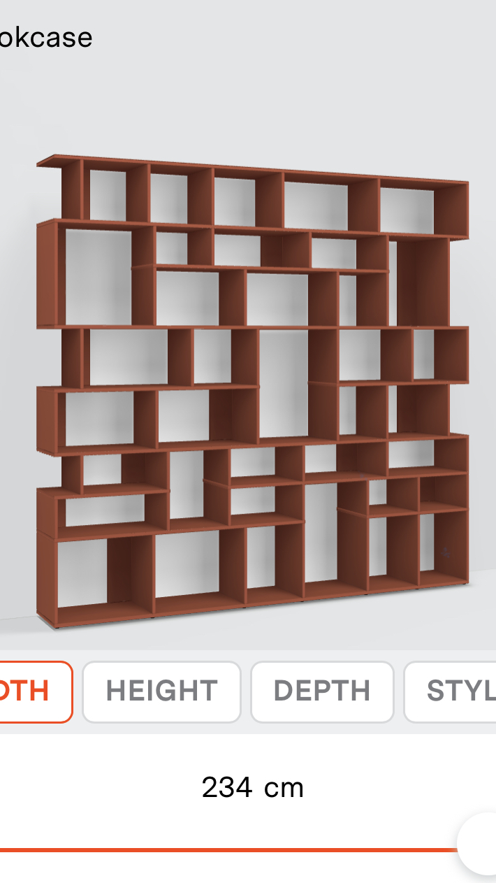

As a reminder, here’s the plan I am following:
Q. How am I going to slot in the top section so that it is flush with the ceiling?

2) my clamps won’t go as wide as the bottom row of my bookcase. Is there a workaround to when I glue and screw these sections? Trying to avoid purchasing a new set of clamps just for these taller sections.
A loop of rope around the entire thing, tightened by twisting up a bar or bit of timber in the rope loop?
You normally don't take any piece of furniture that close to the ceiling because you just can't assemble it and lift it in position, as you have discovered.
I've only seen this sort of thing done a few times in fit outs. The result you want was achieved by building-up the unit (actually, the units come in either as a single piece, or if larger as several parts which go together in situ), with the unit packed up to a defined datum, checked with a laser. The ceiling was then framed out and built up to the unit. I suspect that is how your example was achieved. Used the technique in several bars and restaurants. But this isn't really what you wanted to hear, as overboarding a ceiling probably isn't what you want to do.
I suggest you accept the compromise and build the unit maybe 50 to 60mm below ceiling and infill the gap with some MDF upstand, set 100mm back from the edge with caulked joints and painted out to match the ceiling
