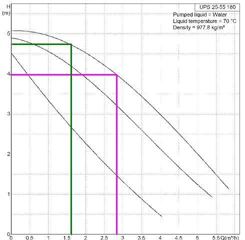

From the Mexico manual the output is 36.6kW so at an 11C drop the flow rate is 36.6/(4.2 x 11) = 0.79 l/sec (47.5 l/min, 2.85m³/hr). From the flow rate/pressure loss graph on page 7 of the manual we find that at that rate the boiler loss is about 110 mbar.
This graph shows the Mexico data plotted as the purple line
At the required flow rate the head will be 4m or approx 400mbar. We know that the boiler loss is 110 mbar, so the loss though the rest of the system must be 400-110= 290mbar.
Now pressure loss is approximately proportional to the flow rate squared. We know that the flow rate of the Ultrcom at max output is 1.633 m³/hr, so the circuit pressure will reduce to approx 290 x (1.633/2.85)² = 95 mbar.
The loss through the Ultracom is 4.05m or approx 400 mbar so the total loss is 400+95 =495mbar, say 500 mbar or 5 m. The green line shows that at the required flow rate the pump can only deliver 4.75 metres, so the flow rate decreases until it can it deliver 5m.
If we now put the new boiler data (flow=1.633, head = 5m) into Grundfos's sizing tool is comes up with either the UPS 32-60 or the Magna 25-60. The left graph shows the data plotted for the UPS, the right for the Magna. You will see that the Magna has plenty of spare capacity to cope with higher pressure, if necessary. The UPS suffers from the complaint of all fixed speed pumps - you have to run on the curve all the time. The numbers 1,2 3 and 4 show how the pump operates under reduced load at various times of the year.
