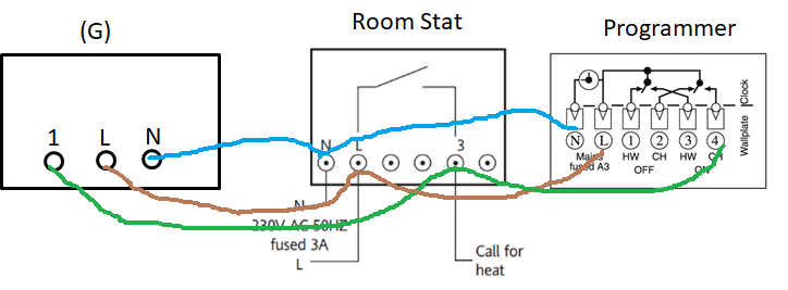

It has N,L and 3 which is call for heat. Things are making sense and clearing up for me! So for Thermostat to work, the link between 1 and L has to be removed.
With Therm Stat out of the way, programmer doesn't need to get N,L from boiler? Does a SL or other cables need to go to Thermostat?
When you installed the link between L and 1, am I right in thinking there were no external wires connected to the G terminals? That would mean L gets 230 volt from inside the boiler, and a roomstat would be connected between L and 1, and the link removed.
If using a programmer (as your attachment) CH on from the programmer to the roomstat, switched live from the roomstat to G 1 on the boiler. No need for an external 230 volt to G L.

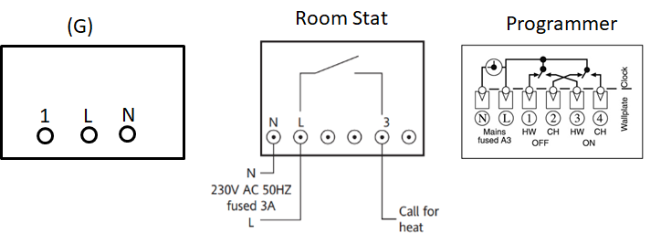

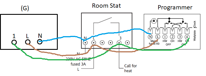

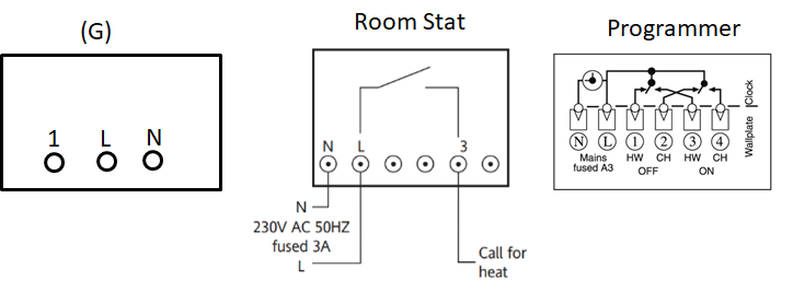

See attached schematics; a marked and unmarked version. I have attached un marked for corrections (if any)

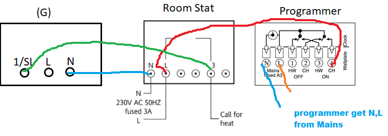

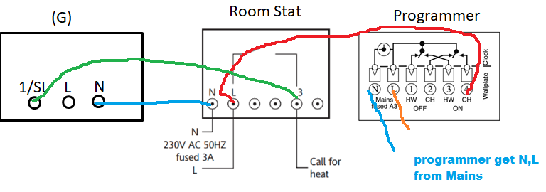

I don't think that's right. I'll try to mark something up, but in words -
L on the programmer is usually fed from the mains (via an isolator). I suppose it could come from L on boiler G, but not normal IMO. And if it was done that way, it would go from L on boiler G to L on the programmer. As you've shown it the roomstat gets Live when the programmer is not calling.
Fused 3A L, and Call for heat on the roomstat confuse things and shouldn't be there.
4 on the programmer should go to L on the roomstat.
3 on the roomstat should go to 1 on boiler G. Better that way round as roomstats often have a booster heater between 3 and N.
No need for any wire to boiler G L.
It should be wired this way as per schematic?
