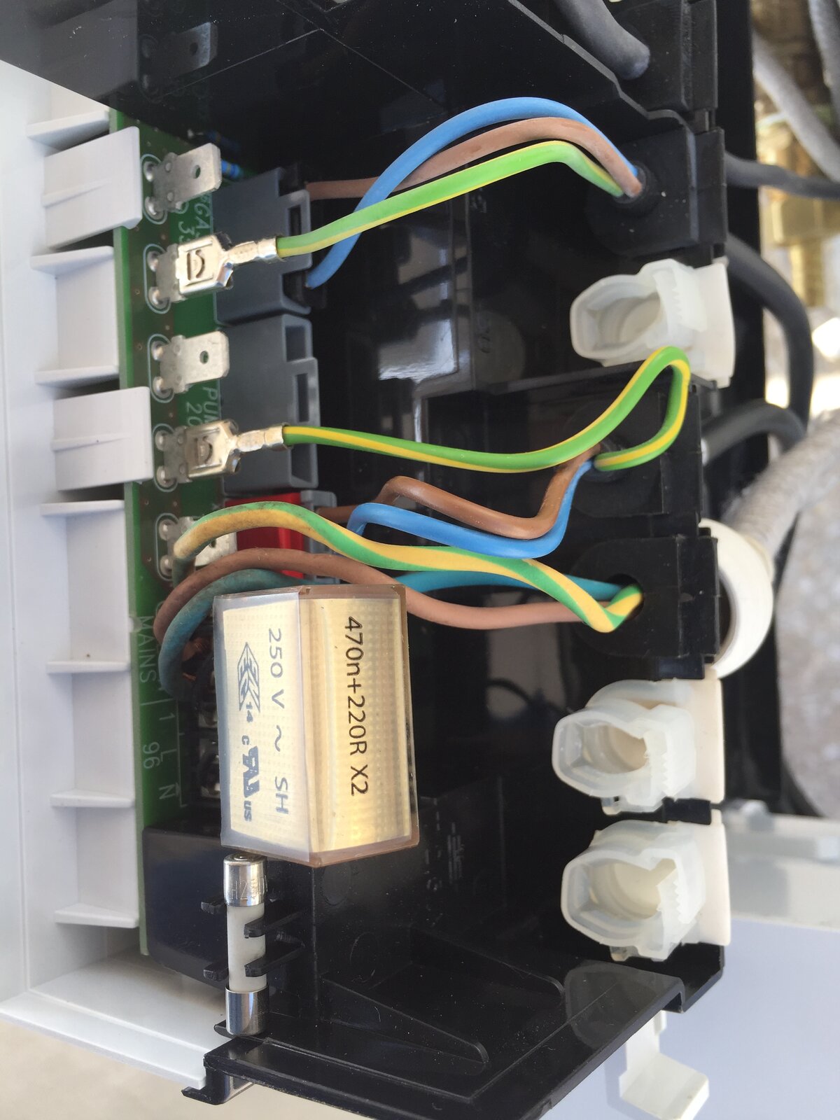

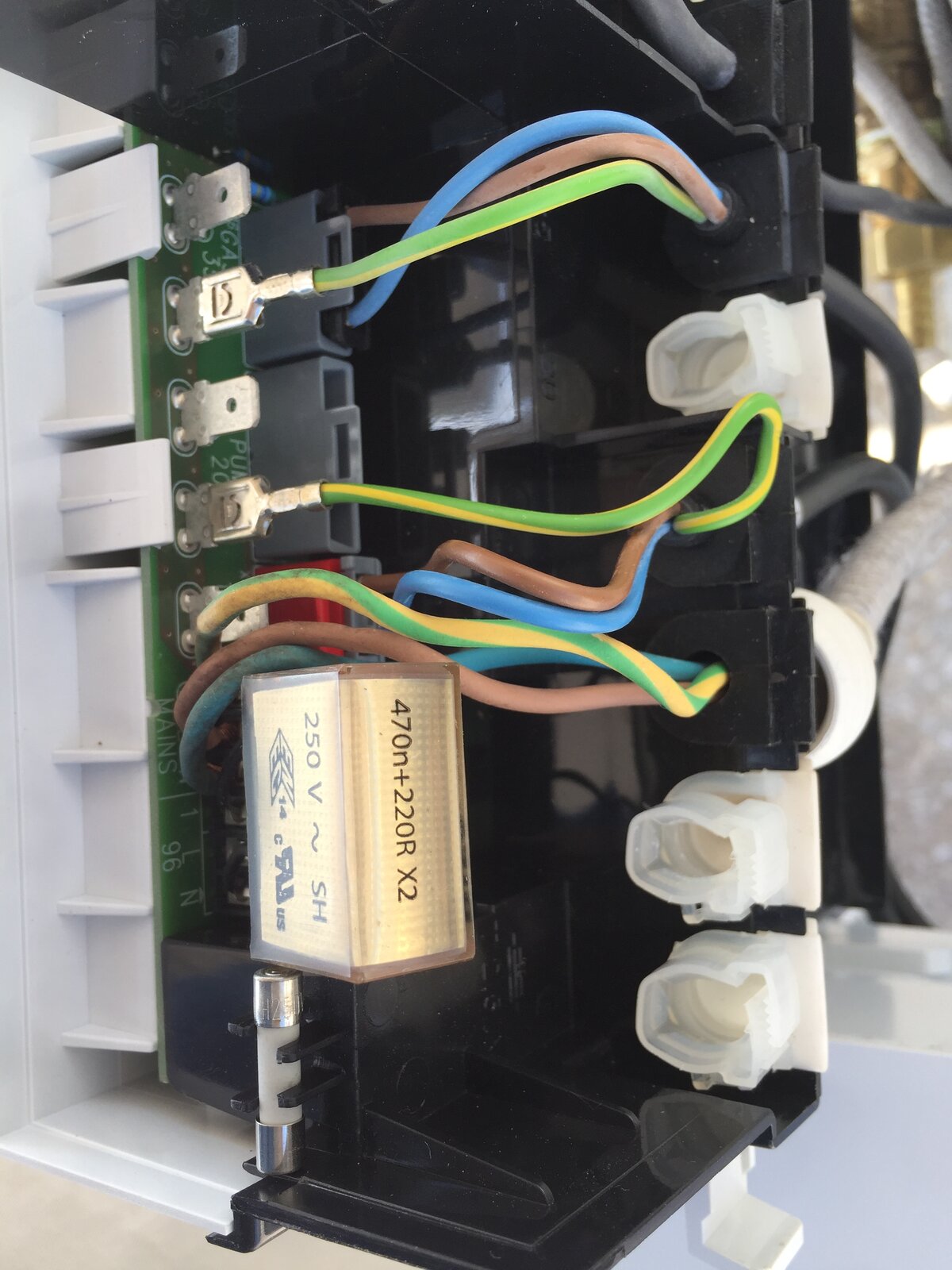

L and SL (1) are to and from the stat, whereby the live runs to the stat and the SL (1) returns from the stat.
So that L/N/E are running from the 230V accessory connectors (G) out to your 'wiring centre'?
It does also state in the MI if there is no pump connected to that slot (D) then a frost stat should be connected, looks like it might be looking for a connection of some type at that point (D in the MI snapshot I posted)

It has to have an input to tell it to fire (and to stop when the signal goes). Without a roomstat, if you link L and 1 on G (Madrab's diagram) it should fire, and run start/stop on the control-stat. But need to ensure the pump is running, powered separately if it's not fed from the boiler.
I can try connecting Room Stat to SL (1) to see if it works? You reckon that boiler should fire without anything connected to external control ports?
As long as the bridging wire is in between 1 and L with the capacitor then that closes the switch for calling for heat, as far as external control are concerned. So the boiler should fire when set to on.
L/N/E are going out (F) to wiring center. Nothing going in to the board or boiler PCB.
That is the boilers main power connector, so the mains should be feeding that connection permanently, that can be via the wiring centre.
Reading through the user instructions the boiler should run without any external controls as long as the heating dial is set above 0 and the bridging wire is in place with the capacitor.

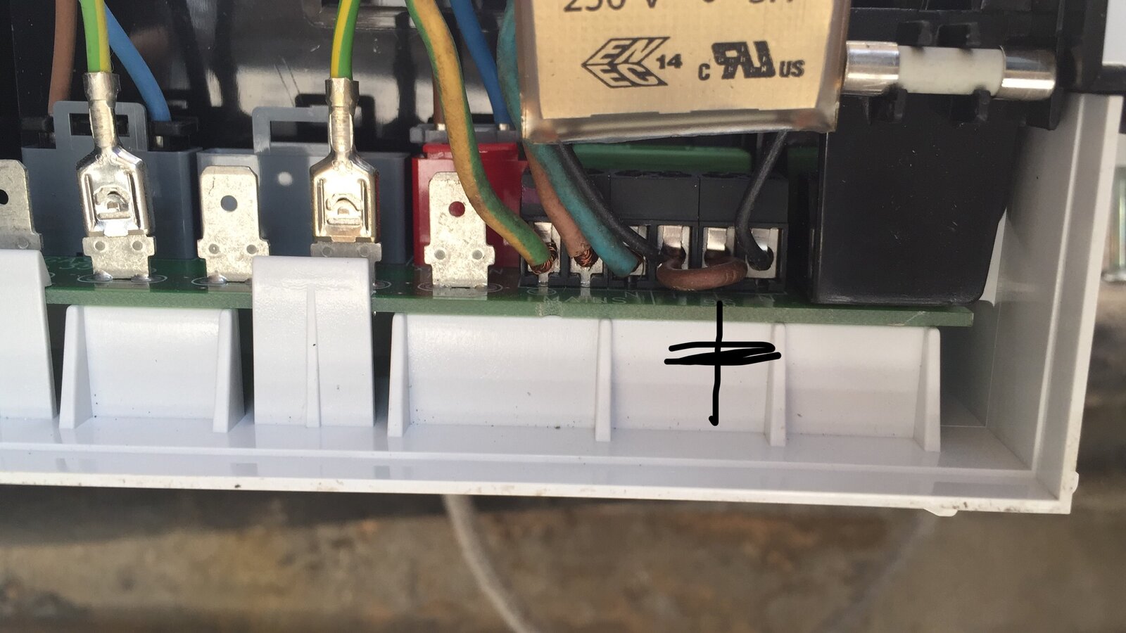

Looking at your picture I cannot see if there is a bridging wire between 1and L on connector 96 (G)? if there is no wire there (and capacitor) it will not run under normal mode. I can see the mains N and L beside it but nothing in 1 and L to the right of it or is the bridging wire hidden?
I can confirm this is the case.
No
No bridging wire between 1 and L on 96(G). That is exactly what it is doing and is not firing up. I'll try the link wire and report back.

The link wire was indeed missing and it did the trick! Thank you @Madrab and @fixitflav

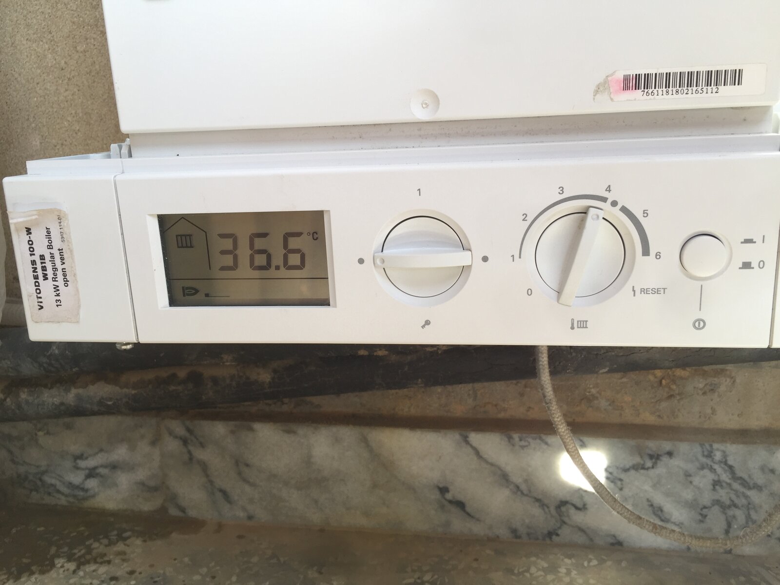

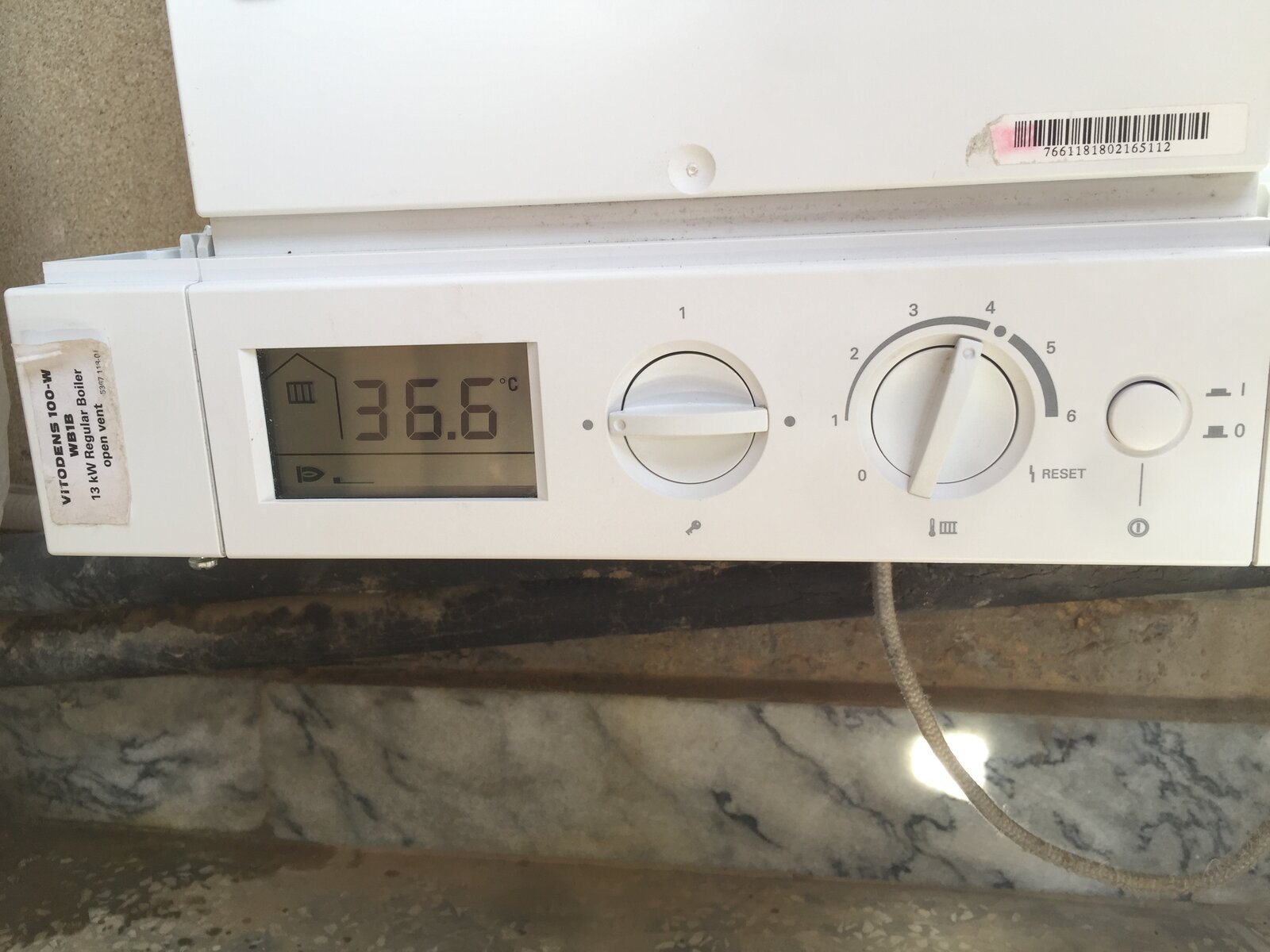

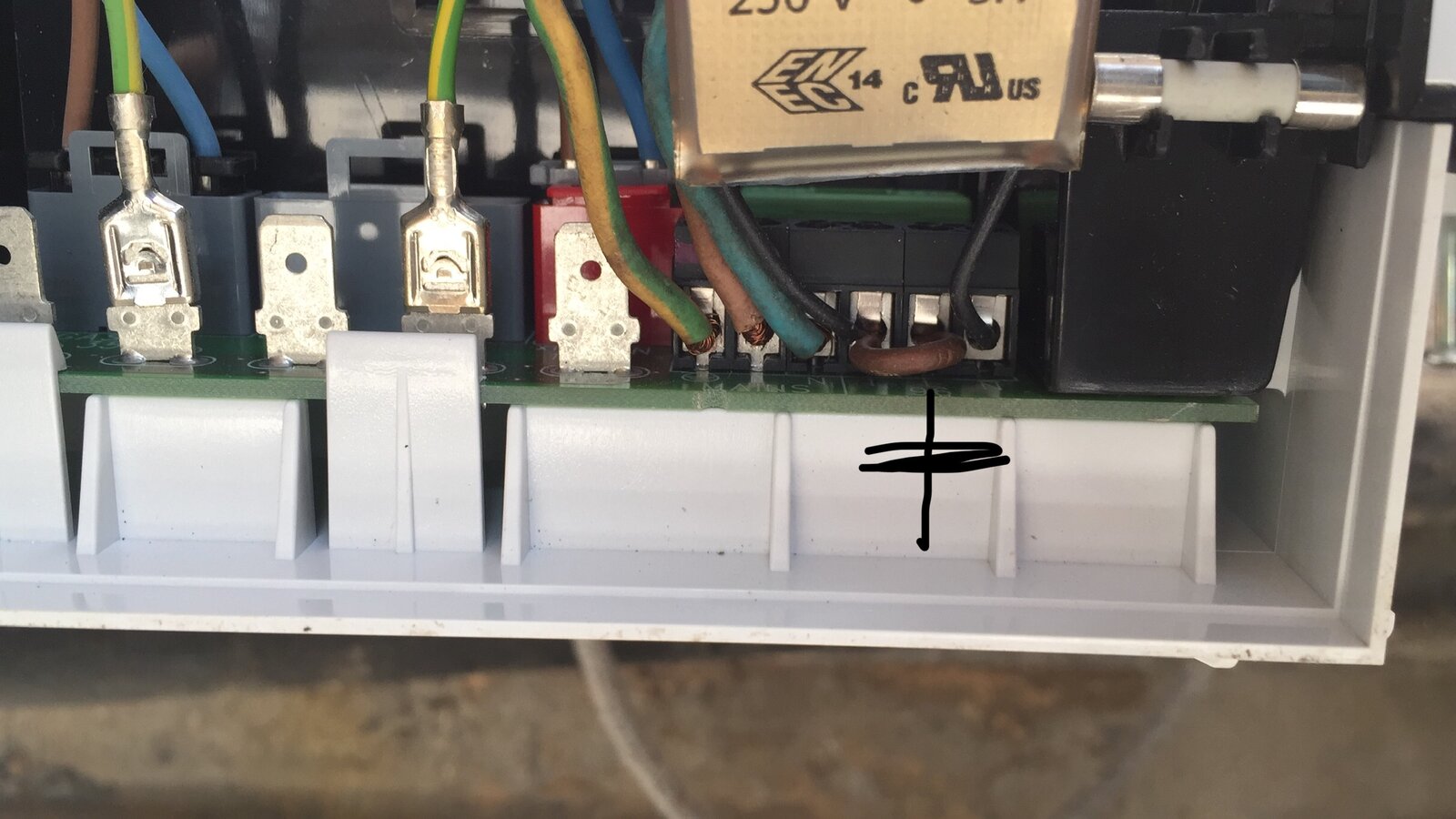

- The flame symbol on display (burner fire power) remains on min firing rate (see pic2 of boiler display), I have tried setting the flow dial to 4 or 6 but firing rate remains on min setting. In Serv mode as you increase the settings on dial from 3-6 th the firing rate goes up with the dial as well but not in normal mode where logic says it should. Instructions doesn't say much on using the dials except to go into Serv mode for flue analysis.

My understanding is that it is a modulating burner, correct?
Yes the boiler will modulate and should really only fire at full rate when everything is cold until the system water reaches the dials set temp. if it never reaches the set temp then the only other process that would normally impact on that would be if the weather compensation module was fitted.
yes, it should but it is not doing it, it keeps the flame at min setting. Prior to the link wire glitch I tweaked settings in Serv mode. I will reset it again, I also read somewhere, don't remember, that in serv mode you can set burner modulation rate and leave the setting for 15 seconds to make them permanent. I will give it a go. I have checked it, the WC module is not fitted on this one. What is your recommendation fitting one for future?

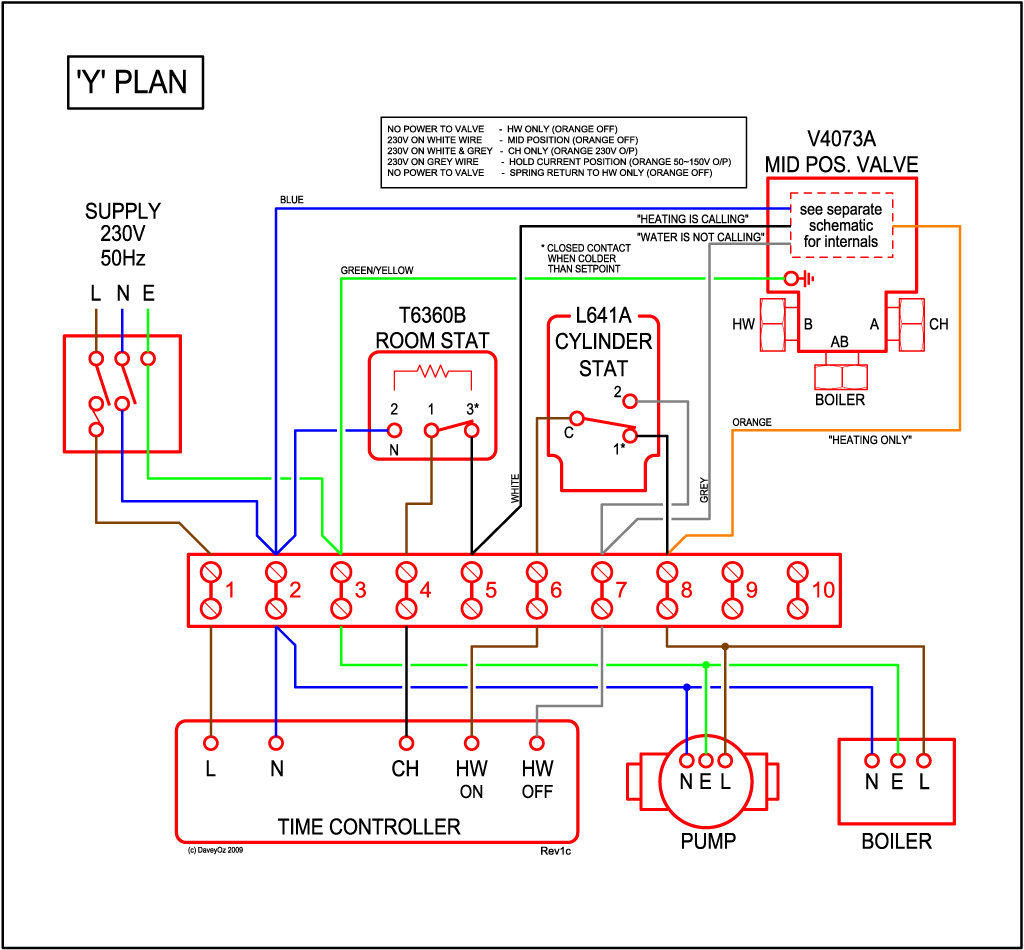

If you're installing a programmer then that's different again, especially if you are using zone valve(s) and a hot water cylinder? If I remember rightly there's a 3 port valve, if so then you need to go and look at a Y plan wiring diagram.
