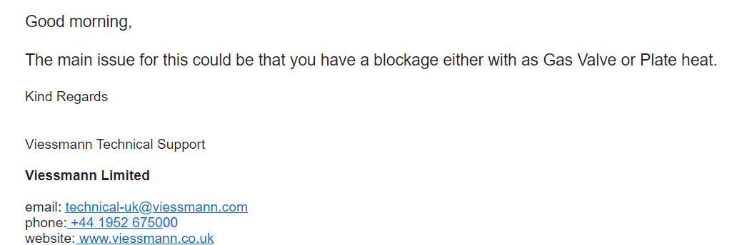

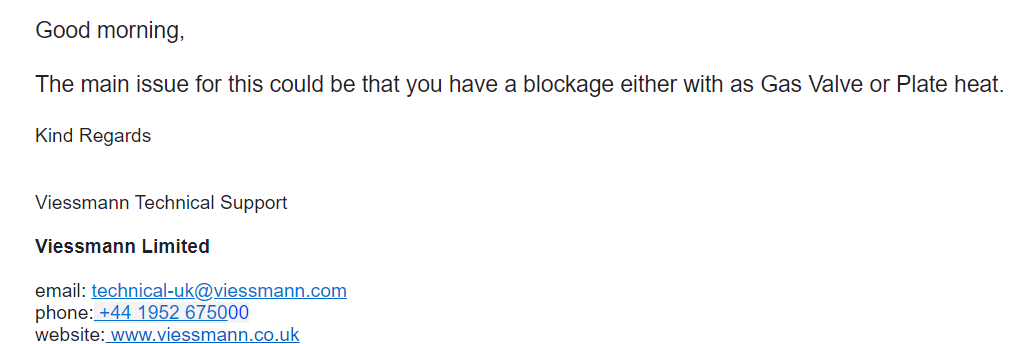

Message from Tech support; Ruling out a plate heat exchanger since it is heat only. Is Gas valve serviceable item? Its not, I have been told by Tech Support.

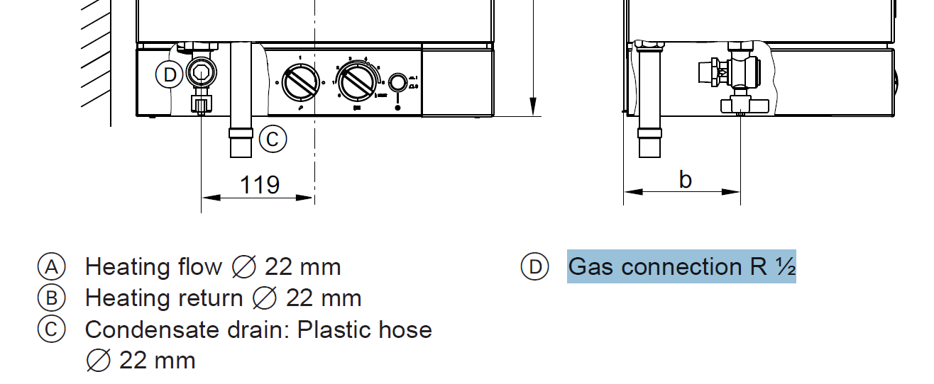

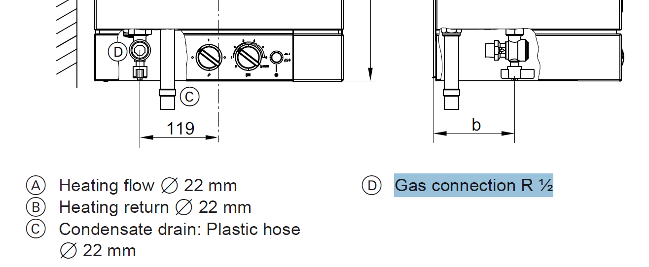

I know for combi's min gas pipe should be 22mm, what gas pipe size should be adequate for heat only boiler.
Gas inlet port on boiler is R1/2 (see attached), after putting the adaptor on male thread of the gas port the size is reduced further down to the gas service pipe, could it be in adequate gas pipe size?
If it is inadequate gas pipe size why does it run fine on Serv mode?
Not sure what you mean by that, but Viessmann are clutching at straws IMO. For 13kW, 15mm pipe is fine unless the length is unusual. And that's with supply from a meter at ~ 20mb. You have 35mb. And as you say, If it is inadequate gas pipe size why does it run fine on Serv mode?
Couldn't agree more.
The pipe length is not unusual, its hardly 15 ft from gas service line which is 1.25" from meter.
I also asked viessmann about min pipe diameter for gas line, their response: 'MI asks fr 17mbp at the valve before fire'.
I also stand corrected on WC for gas which is 20mbar where I live and not 35.
