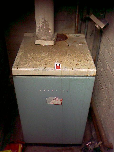

Came across a Crane Cavalier a few months ago, 45 plus years old I reckon and still going strong, no leaks from gaskets but just showing. The door alone would make an Apollo, double skinned and insulated.
Not that I propose the client should continue with it but it did it's job.
