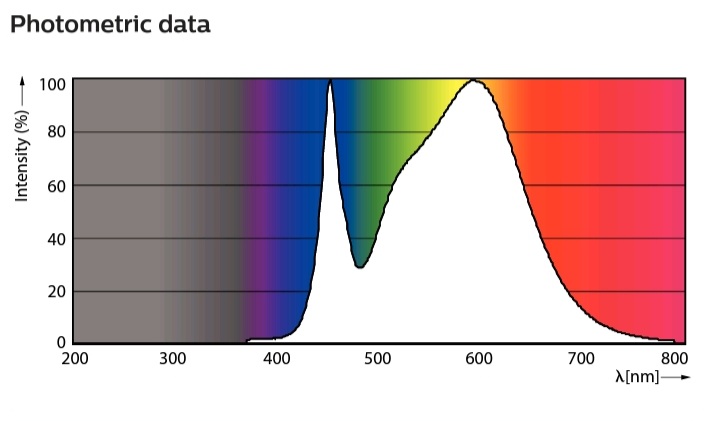

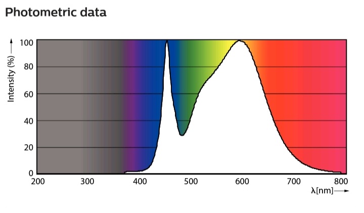

...and an interesting sidenote to me :)
Nice photometry diagram from the datasheet, showing the blue LED at 450nm and the phosphor emmisions providing the 'white' light output.
Edit: blimey I'm slow - that means it's still a fluorescent tube! ;)
