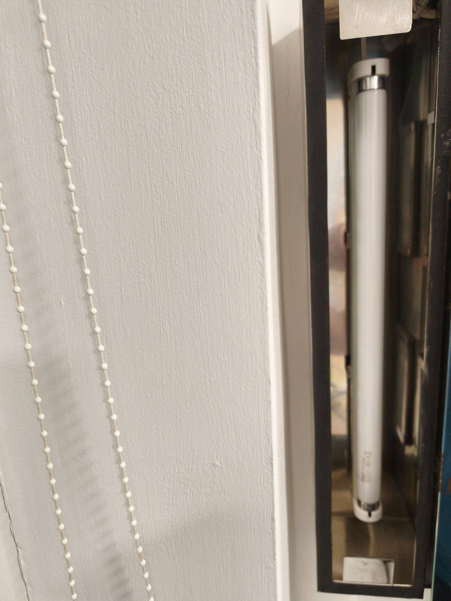

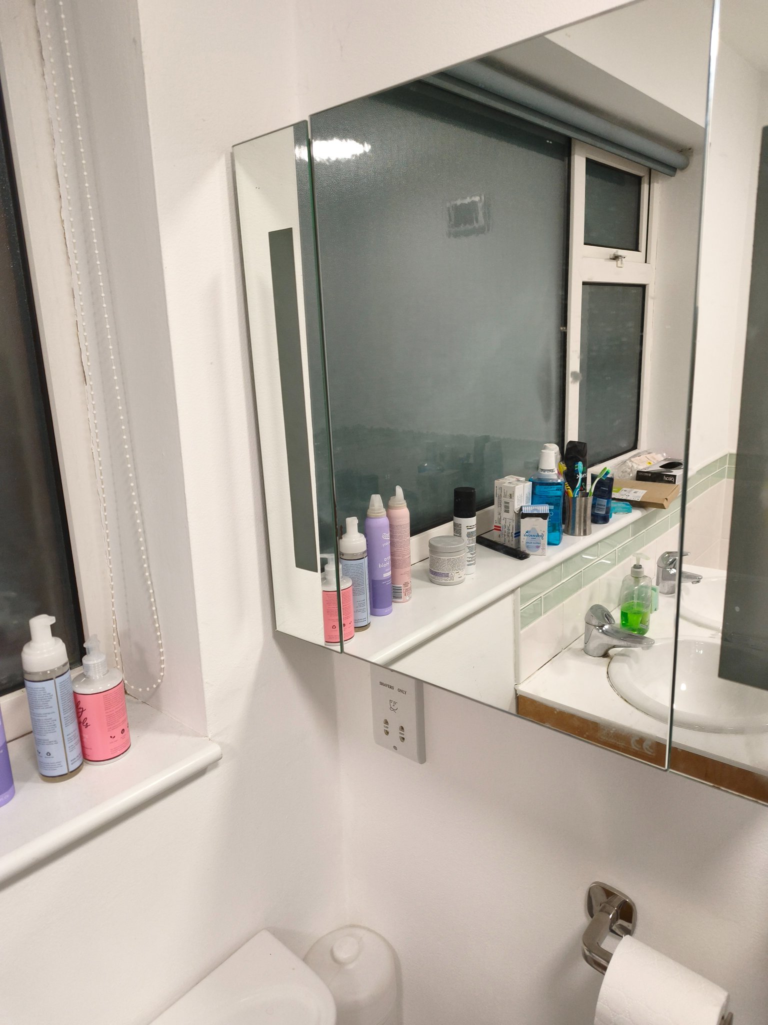

Here's the outside of the cabinet with the two compartments that contain the flus at the moment.
And inside, you can see the glass windows that let light in to the interior of the cabinet.
And inside one of the compartments
Can't find anything bigger than 7W that will physically fit inside the compartment.

As I said before, 440mm. I made a booboo, though, they are not 18W tubes (otherwise they'd be 600), they are 15W.
The picture above shows extra space above and below the fitting, but the one on the right hand side has a shaver outlet immediately above it, so putting a longer fitting in is a no-no.
I'll have to take out one of the fittings and see how it's arranged. Having looked at the reviews, a couple say it comes with a starter, but as far as I can see, these ones are HF.
