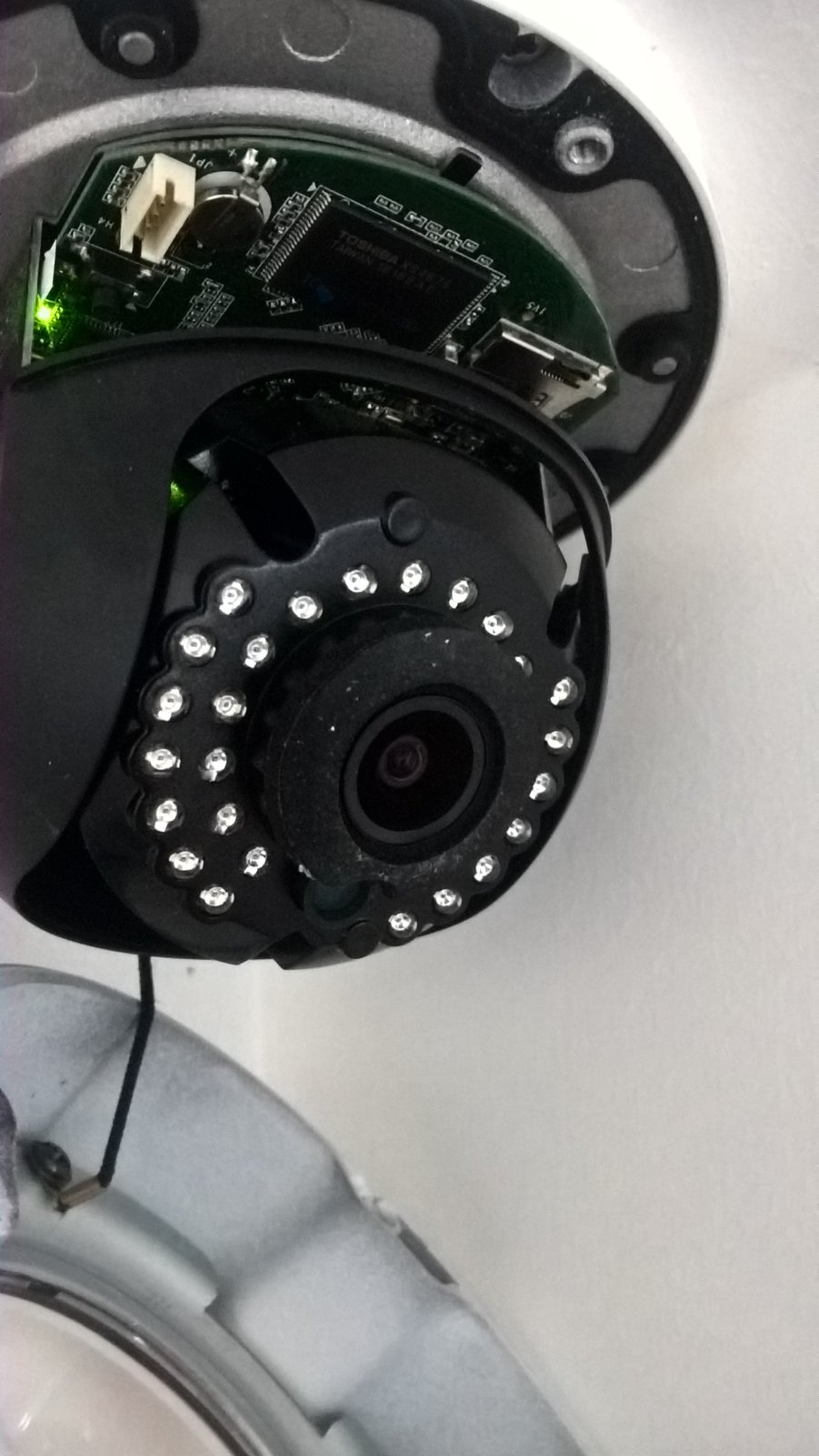

I'm experiencing an appalling picture on my external cameras during darkness and diagnosed it as IR Bleed based on my trawl of forums.
I then embarked on pulling the so-called foam tight and against the glass of the Dome. But I only see a tiny bit of sponge which is fixed to the lens. Incidentally, there is a gap between this and the dome but I can't move it around.
help please.

The foam is there to protect the lens from the IR illuminators. You'll need to ensure it's clean with not misshapen, no dints or bits missing. When re-assembling ensure it's seated squarely and that the glass is a snug fit all the way round.
If you get nowhere you'd be better off buying a higher spec camera as they separate the lens properly.
The foam sits on the base correctly but isn't thick enough to reach the glass of the dome. I only brought these Hikvision dome cameras 4 months ago!

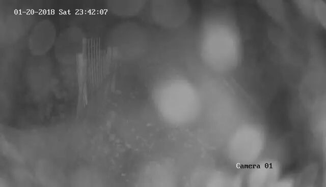

Hi,
Here's the picture I am getting on my external camera this evening. I haven't cleaned yet as it's been tipping it down all day.
Please let me know your thoughts.
Never use this type of camera for external use ....the sun will also bleach the cover over time so your wasting your time ....ok for internal as long as the lens is not scratched
Agreed with above, the slightest mark on the dome bubble will reflect the infra red at night time even if you do manage to adjust the foam properly. I'd recommend the turret style cameras for external use.

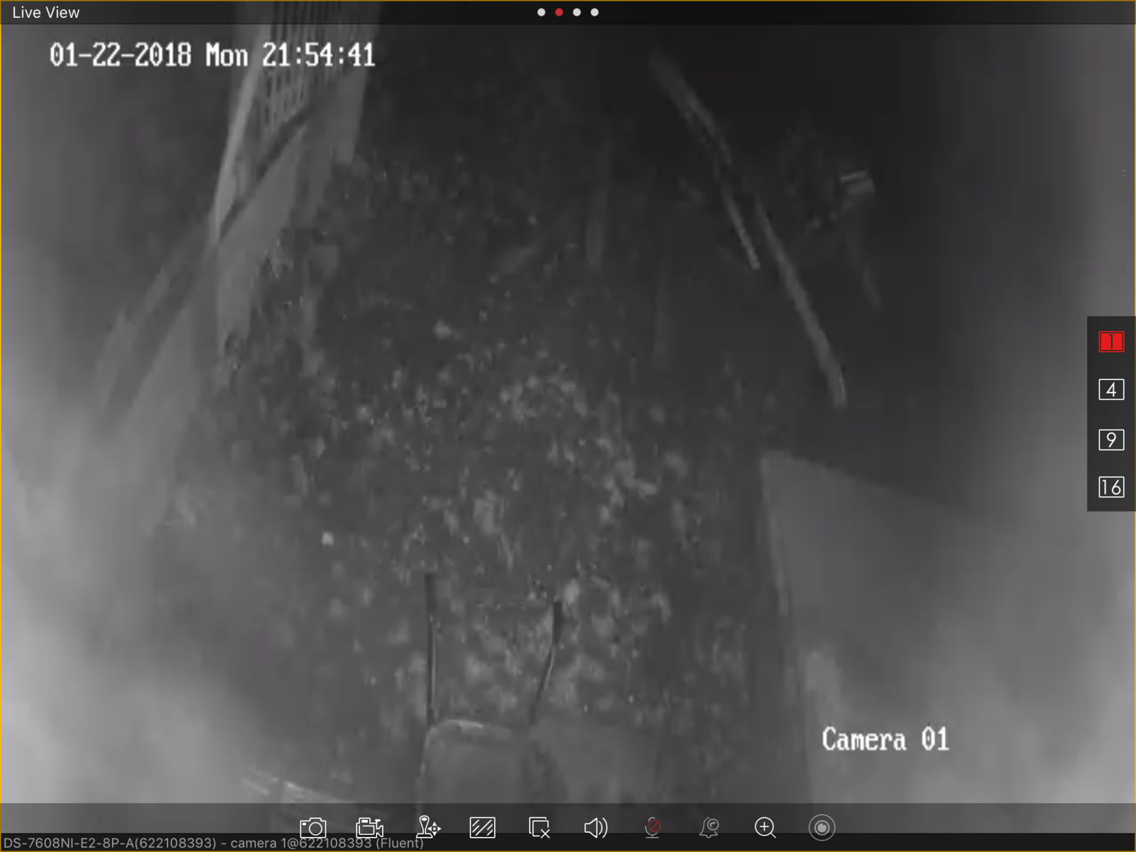

Hi,
Looks like rain has dried on the cover causing the ir to reflect. Glass cleaner with microfibre cloth. Might also be worth gently wiping the lens itself.
A clean has helped but the picture is still not great. Any other suggestions?
Replace with a camera that isn't badly designed. Dome cameras with IR LEDs inside the dome are always going to be prone to this failure.
You could get some material yourself and replace the foam if you're desperate to salvage it.
