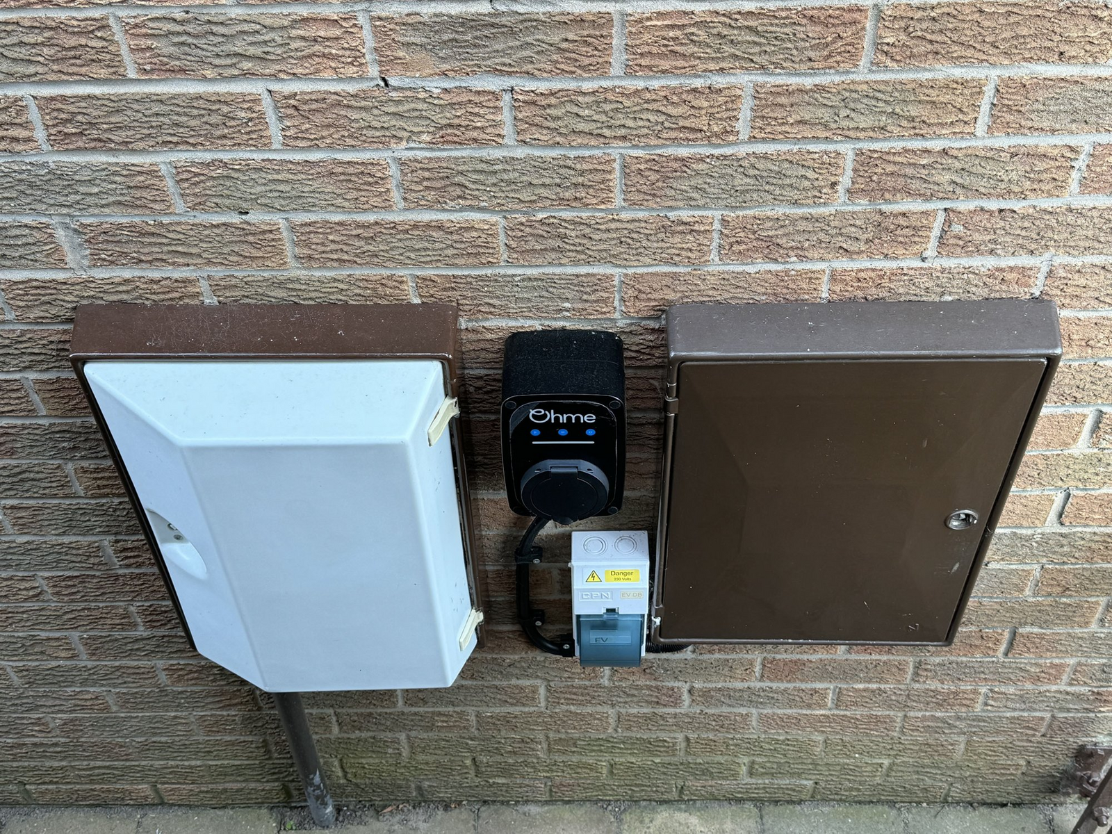

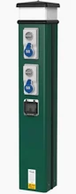

Is this CU rated for external use?
I must admit I have looked at caravan hook up units
and clearly designed for outside use, but seems little protection against the weather.
is this any better than unit shown? I would mount them in something like a bird feeder so the unit is not in direct rain, but seen them out in weather and seem to work OK.
I must admit I have looked at caravan hook up units View attachment 356347and clearly designed for outside use, but seems little protection against the weather. View attachment 356349 is this any better than unit shown? I would mount them in something like a bird feeder so the unit is not in direct rain, but seen them out in weather and seem to work OK.

Certainly not.
Even the ones that claim to be and have seals around the cover are not.
Consumer units go inside the property. This trend created by the EV slingers shoving them on exterior walls needs to stop.
Completely agree, wonder how many have had the cover smashed off with kids playing football.

Those CPN things are only IP65. Not enough, IMO.
You can buy a meter cabinet, which provides quite good protection for equipment inside it. The triangular keylock can be changed to a camlock or other.
Weatherproof steel cabinets are quite a lot more expensive.

The sockets can be used outside at IP44.
However the circuit breakers, RCD and any other protective devices cannot, as they will not be rated to be installed in locations which have extremes of temperature and humidity.
The presence of a cover over them changes nothing as at some point it will be opened, and even the most well sealed enclosure outdoors will inevitably get moisture and condensation in it.
