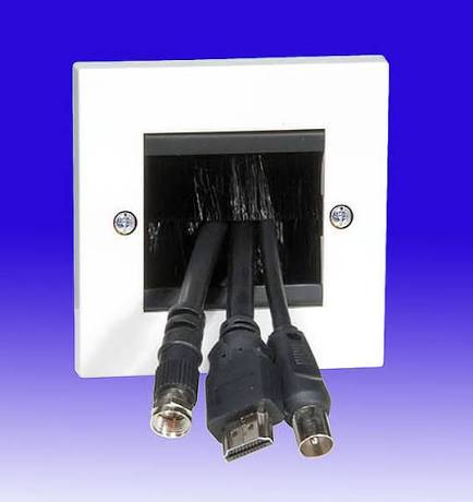

Just use a double ended joiner, and a brush plate? Or cable straight out of the brush plate.
Note that flexi stranded cable will need the correct euro module (screw terminals?) cf solid core punch-down IDC (Krone block style) module. They also need reasonably deep back boxes... not 16mm lighting or 25mm socket... probably.
PS You'll have to be lucky to get Openreach to fit in the loft (is there safe access). A small bribe with tea and bikkies would do no harm ;)
Again, thanks for the response. While I am more than able to install the CAT6 cable and fish it through the boxing were the sewer pipe drops down, I assume this is a brush plate?
or this
Is it basically a wall mounted joiner? Presumably it does not need a back-box?
I think this is what was meant by brush plate.

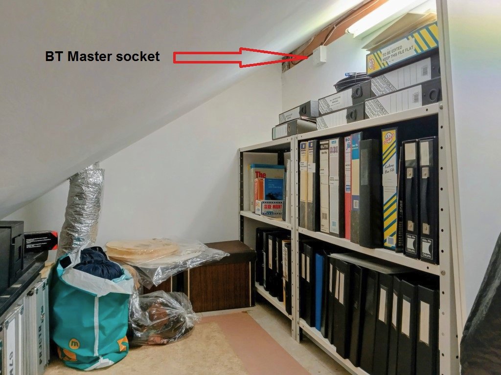

Forgot to mention that the EE guy told me that Openreach will not work in the loft unless they have had special H&S training, and not all have. But of course, it is ok to work up a ladder at 9m.
I know they don't know how my loft is but for the sake of clarity under this thread, here is a photo. From now on, I will call it the second floor! And yes, there is a great ladder to the second floor.
I had a problem years ago with Sky, they fitted a dish, then when it had problems, said they could not work on it due to health and safety even when they put it there to start with.
It would be so much safer if Open Reach could work from home!

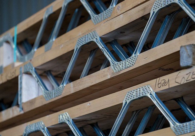

I have been somewhat unsuccessful it getting the CAT6 cable routing. It has to go about 1.2m horizontally, through the Posi-joists and next to the horizontal section of sewerage pipe. Should not be a major issue except the entire void is filled with Warmcel insulation. Have managed to get a 1.2m length of heavy duty earth wire about 1.2 / 1.3m, where I have a 100mm access hole, but damned if I can find the end.. Can only get my arm a limited distance inside, but unable to find it. And every time I try again, the result is the same; nothing. It's a case of so close but so far!
It can't go up (flooring); it can't go down (plasterboard ceiling); it can't go right (sewer pipe through the Posi-joists). if it goes towards the left, I would have thought tht when extracted, there would be a left curve to the wire, but it comes out more or less straight. it's a real b**ger!
Magnets are a non-starter since the Posi-joists have metal webbing.
