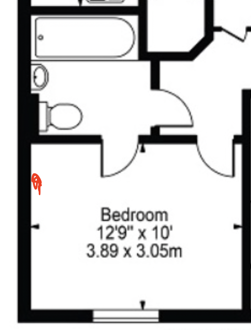

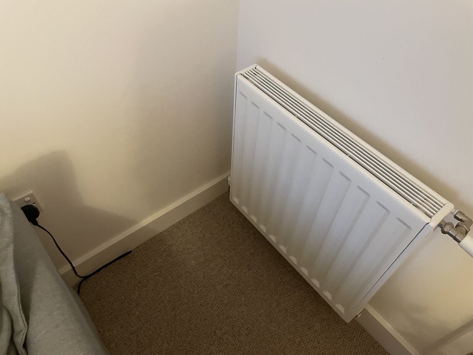

For a very very long time we've been pondering whether to install a Japanese-style bidet seat (something like this).
The plumbing and installation part are relatively straightforward but it is the electrics that have given me pause for thought.

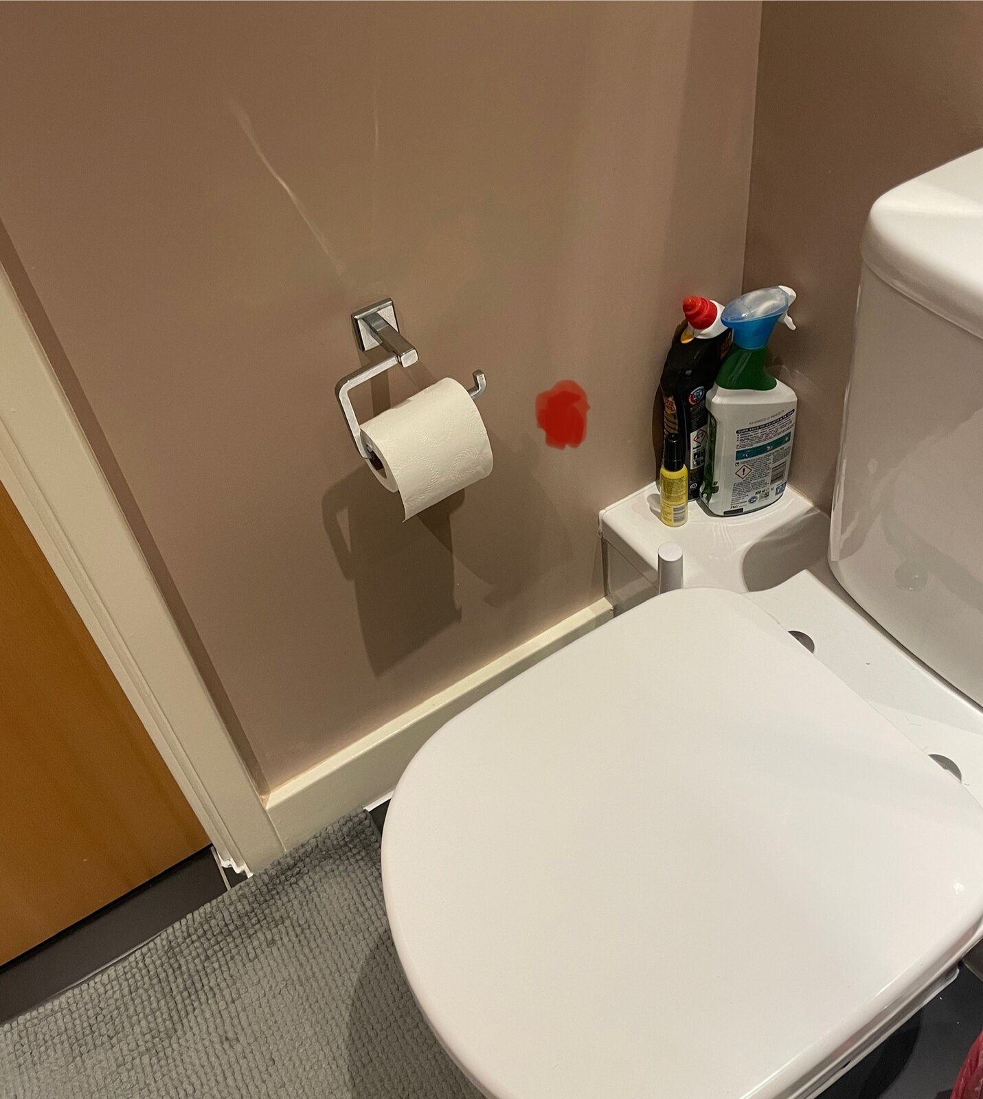

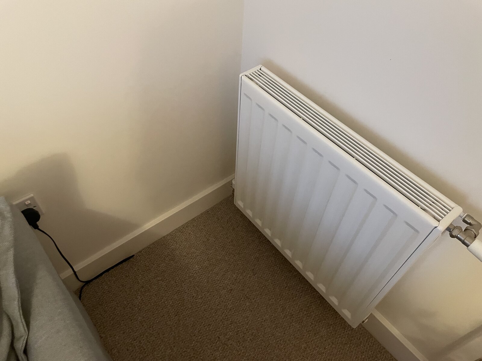

Naturally, there is no plug in the bathroom, but there is a plug relatively nearby in the room next to the bathroom (see floorplan below, and where the plug is is marked in red). The idea would therefore be to use that plug and run some core electrical cable from the plug, inside the wall (in the picture below would need to go towards the corner and then around the corner and roughly behind the radiator, all this hopefully inside the wall), then drill through the wall in the bathroom (marked in red where it would need to come out) and either install a single plug or, as many people seem to have done with these installations, a fused connector unit (something like this).
Mindful that all this is easier said than done. I'm guessing that I won't be able to feed the cable through the wall without hitting a stud (it's a new build so I expect most studs to be aluminum) so I'm not quite sure how to achieve this. Of course could just leave the cable on the outside, but definitely won't look as nice....
Also, on the electrics, this seem to be what most people who have installed these have done, but not sure if I'm missing something.

If there is a bath or shower in the same room as the toilet, then the work will need registering, the cost to register is likely more than the cost to get a scheme member to do the work.
Of course, you can break the law, possibly I would break the law myself, but if anything goes wrong, you're up the creak without a paddle.
I would use a FCU in the room with the toilet, but it needs to be 0.6 meters from the bath.
The wall is about 1.4m from the bath, so probably OK there

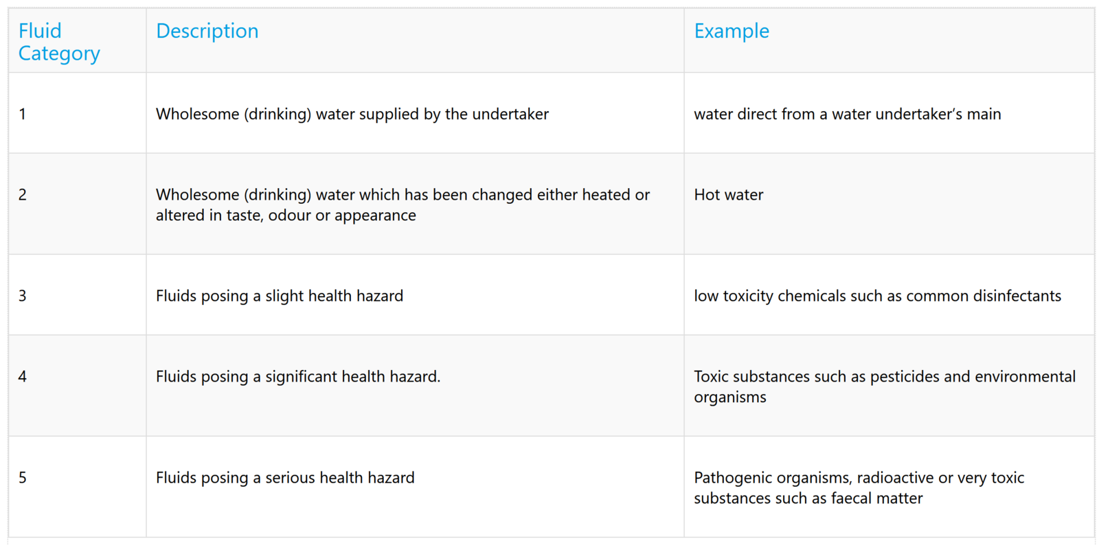

Lower category fluids such as used to supply a garden hose, or in other situations such as supplies to small unvented water heaters.
The only check valves for use on Category 5 incorporate an air gap, and they are only suitable for open end applications.
Interesting. What do you mean by "Lower category fluids"? - most of us only have one type of 'fluid' (mains water) we which use either directly or via a storage tank.

A few drops of water flowing back from a garden hose into the potable water supply will present a very low risk of biological harm.
A single drop of water contaminated with biologic material from a person's anus will present a very high risk of passing disease if it reaches the potable water system
