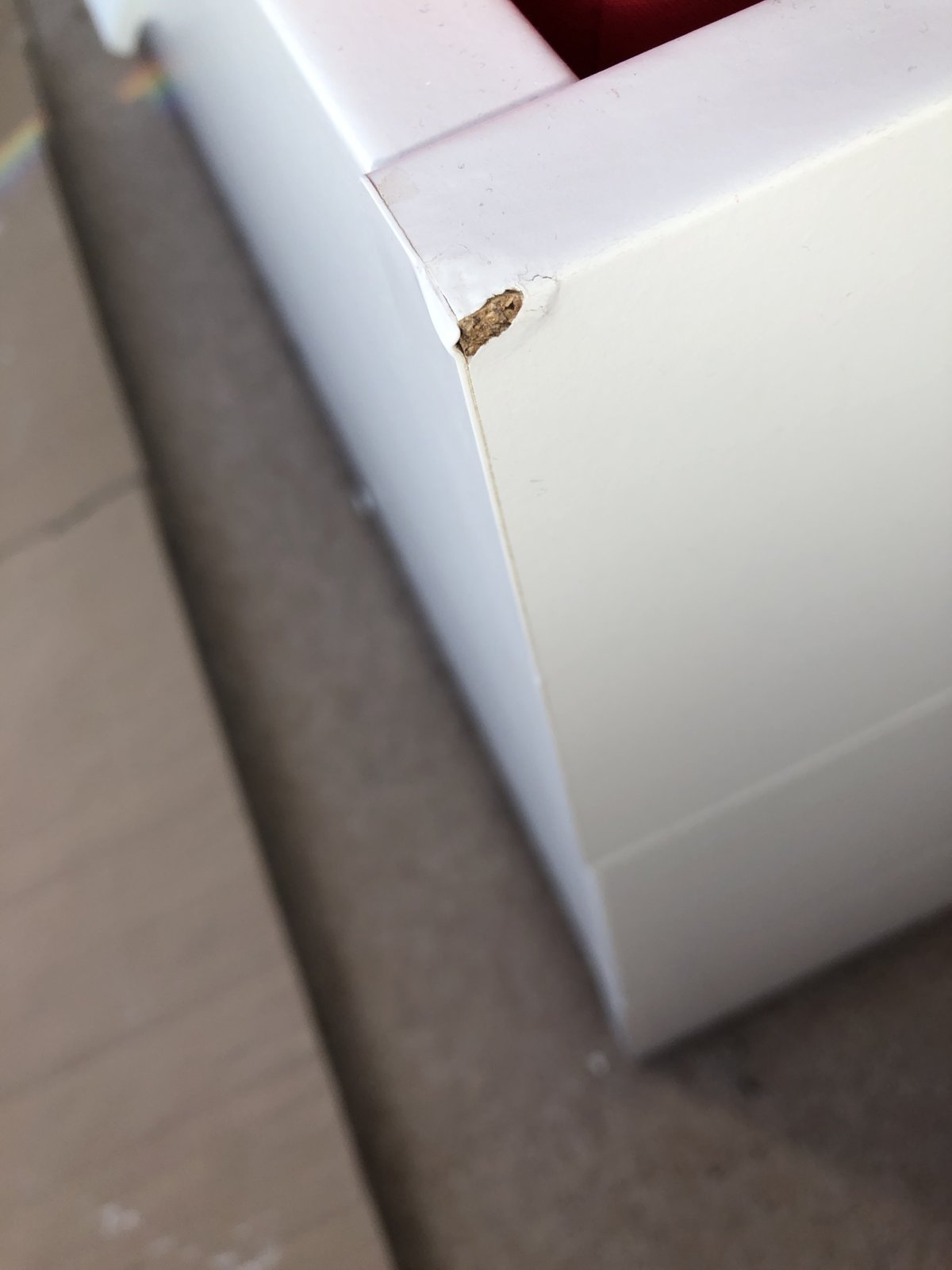

Hi,
I was wondering if anyone has any recommendations on how to fix this type of damage please? (Please see photo)
I have a few similar damaged areas across a number of furniture but this is one of the worse.
I also have damage on a flat surface and heard colorfill was good and has good reviews but I’m not sure how I would apply it to edgers and corners?
Any tips or advice would be much appreciated.
Thank you

No, I doubt that it will work. Colourfill is really a joint sealant/adhesive and cant be readily formed or polished. Your furniture looks to be vinyl wrapped particle board with PVC edge banding. The only way I know to repair that is to cut back, fill with a 2-pack filler, sand (carefully), then spray paint with an appropriate paint (Google "Konig UK" for appropriate materials). Smaller repairs such as scratches and gouges can sometimes be effected using coloured waxes and a spatula
