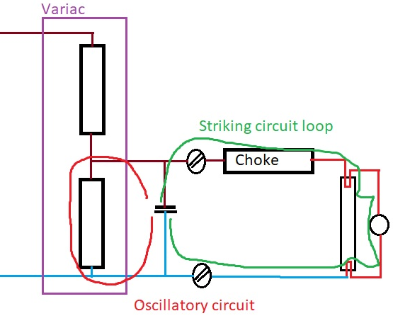

However, I don't see what that has got to do with the Variac "introducing an inductive component"
The oscillatory circuit will affect to some extent the operation of the variac
I understand what you are suggesting, but what I am struggling to to get my head around is the question of why the Variac (which, after all, is just a type of {auto} transformer) should differ in this respect from the DNO's transformer.
What if the the variac was very close to the substation transformer - would you still be saying the same?
Kind Regards, John
... or, to put it another way, what would be different if you replaced the Variac in your diagram with the secondary of the DNO's tranny?
Kind Regards, John

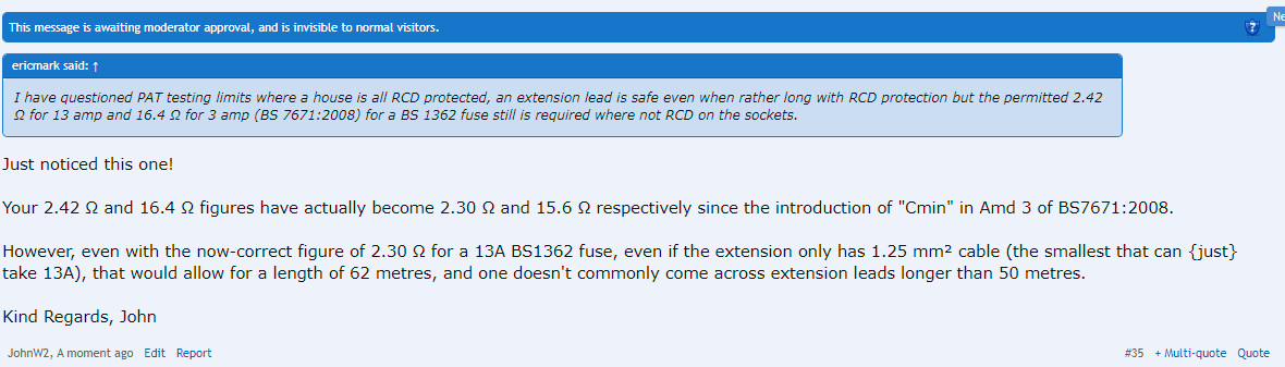

Your 2.42 Ω and 16.4 Ω figures have actually become 2.30 Ω and 15.6 Ω respectively since the introduction of "Cmin" in Amd 3 of BS7671:2008.
However, even with the now-correct figure of 2.30 Ω for a 13A BS1362 fuse, even if the extension only has 1.25 mm² cable (the smallest that can {just} take 13A), that would allow for a length of 62 metres, and one doesn't commonly come across extension leads longer than 50 metres.
