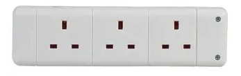

Due to the way this hangs down from the socket
it does not put any great strain on the socket, this
however could, but would depend on weight of cables. Some common sense is required, most units like this
have key hole slots in back so no strain on socket.

Due to the way this hangs down from the socket ...... it does not put any great strain on the socket, this ......... however could, but would depend on weight of cables. Some common sense is required, most units like this .... have key hole slots in back so no strain on socket. ....
The OP is talking about 2m extension leads, so all that get plugs in at the 'supply end' is a single plug (attached to a lead) - no different from anything else plugged into a single socket - no your first two photos are irrelevant. The 'other ends' of the extension leads will presumably have the format of your third photo. We haven't been told where they will be (I had guessed probably just 'lying on the floor') but, as you say, even if they were attached to something using their keyhole slots, there wouldn't be a problem.
... so, in relation to the OPs situation and questions, I don't really understand what point you are making?
Kind Regards, John
Kind Regards, John
