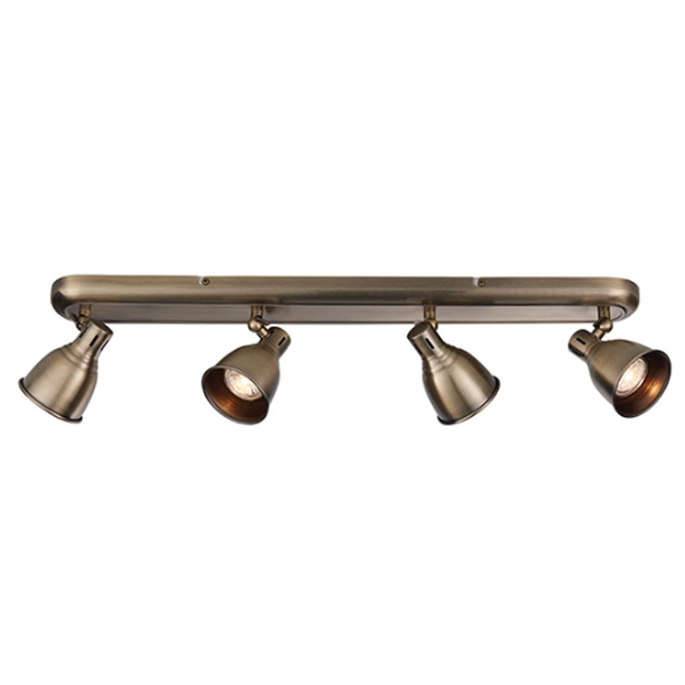

The light fitting is a little bit like this but not quite as fancy (I won't post a pic of our actual light fitting, I don't actually like it and want to change it) and we have 4 energy saver light bulbs usually screwed in. When I find a nice replacement fitting it will be something like this still.
