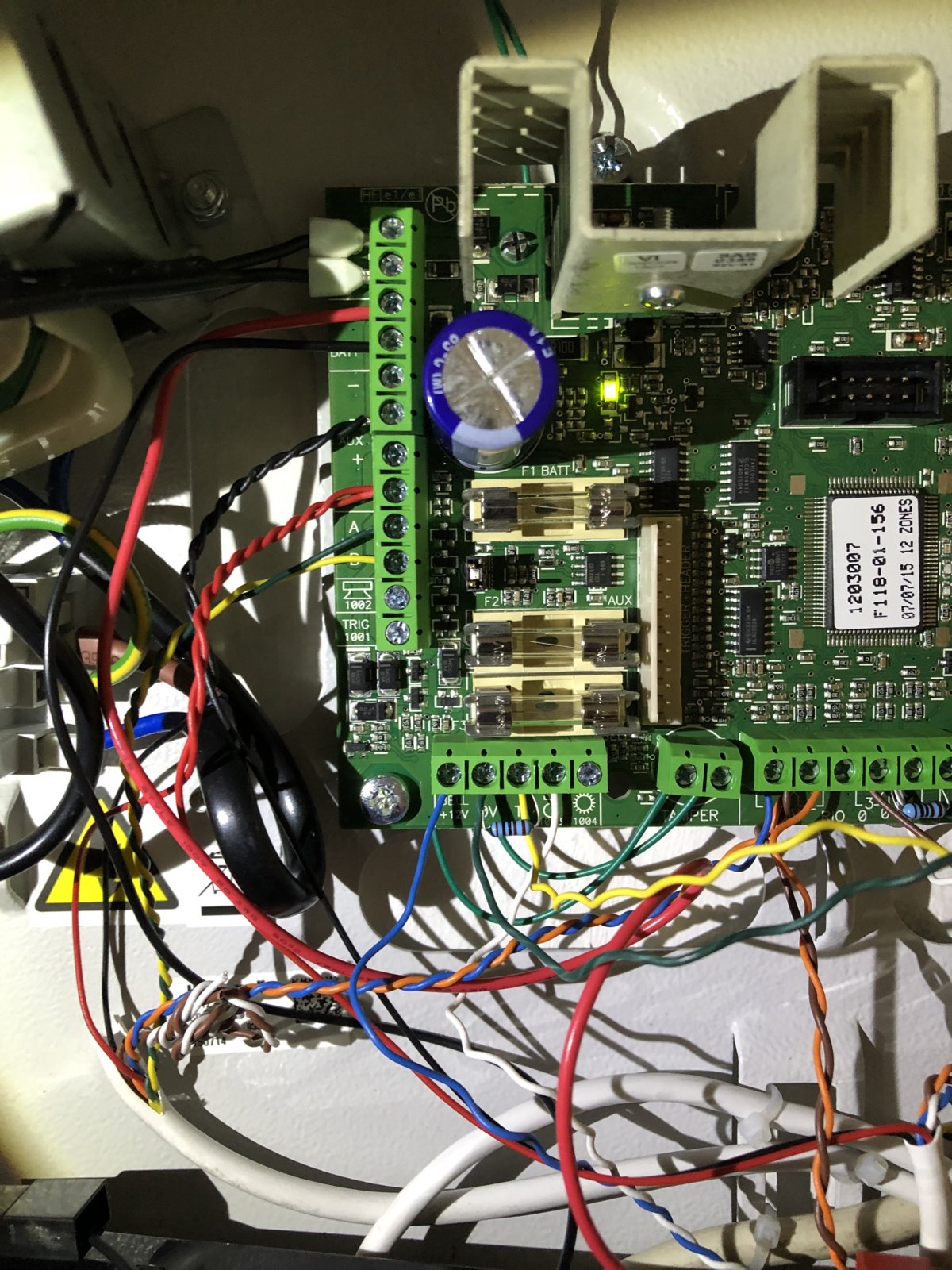

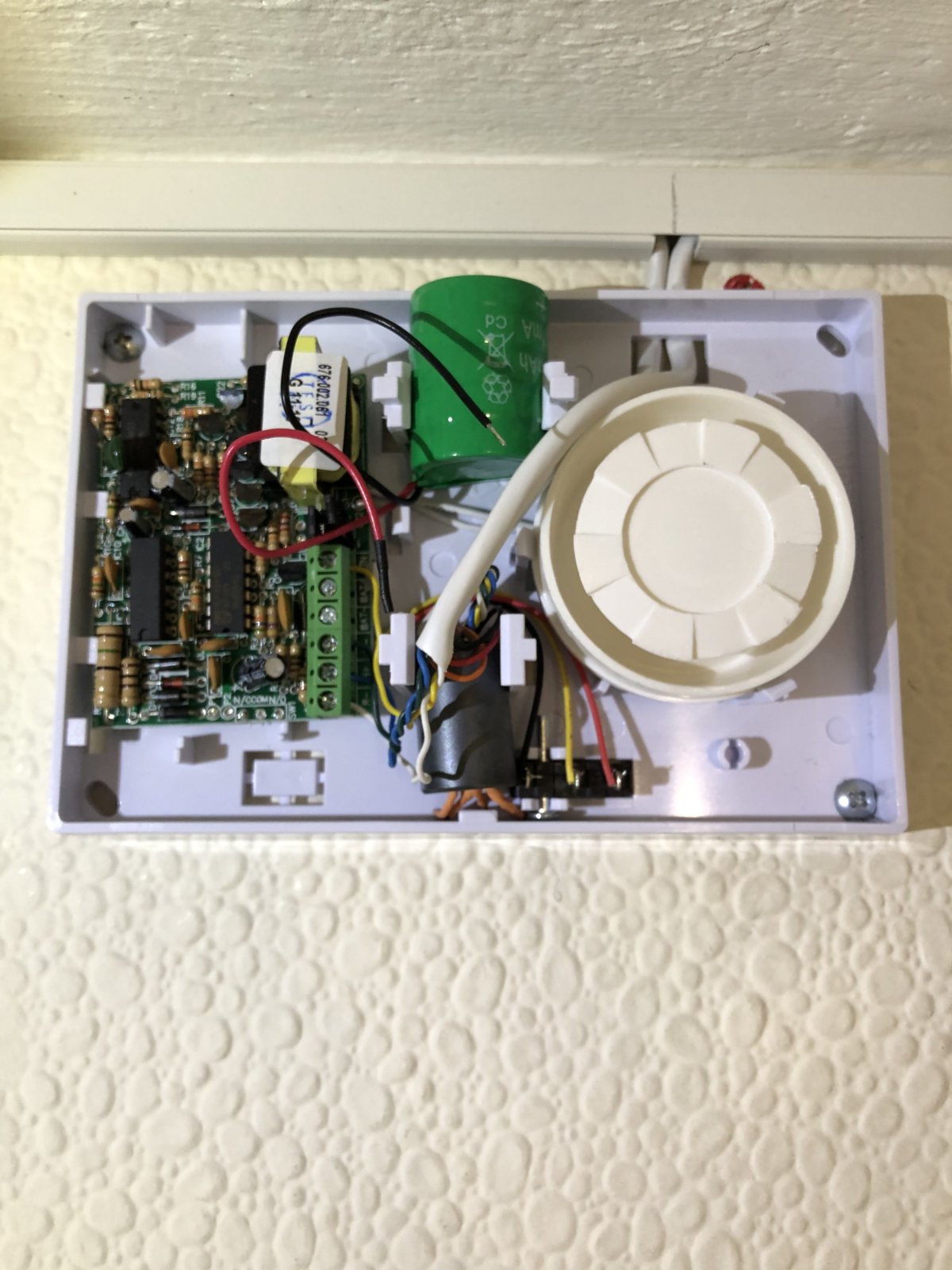

I'm hoping someone can help me. I've recently installed a Honeywell G2-12 into my home.
I've installed all the sensors and everything was working fine.
Lastly I needed to wire the internal sounder (i've decided I don't require ta bell box at the moment). Whilst installing the internal sounder I seem to have created a fault: Bell Fuse, which I can't clear through panel reset.
I checked all the fuses and they seem fine, and have removed the bell wiring.
Can someone help me:
1. Diagnose / clear the bell fuse alert
2. Advise the correct installation of the internal sounder.

F3 is the bell fuse , have you tested it using a multi meter?

Hi, it's likely you've blown the fuse.
A plain 12v Sounders can be connected with the positive going to +12v supply terminal and the negative going to the bell output (symbol of a bell on the PCB). You will also need a wire link between the tamper return T and 0V.

Hi GalaxyGuy,
Yes i’ve just checked the fuse using a multimeter as per sircerebus666 and it is blown.
So I just need to connect +ve and -ve as you’ve described, will i also need to change any settings to be -ve/+ve trigger?
Vin
No, the settings will remain the same. In default settings, the trigger output will be pulled to ground and that activates the sounder.

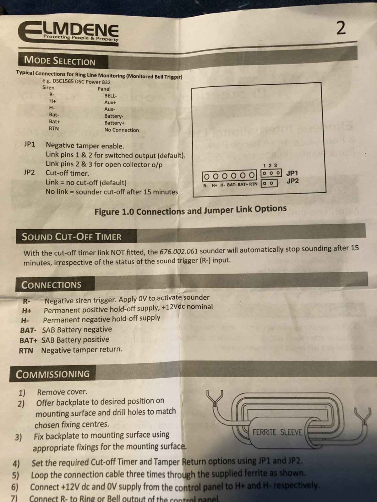

Hi,
Okay i’ll try that. My bell has an internal battery. Originally i connected H+ to 12v bell
H- to 0V
R- to bell
Bridge T to 0V
This blew the fuse, although not sure it blew the fuse because i did it in engineering mode with power still to the panel.
Does what I originally did sound correct?
Vin
Yes, that wiring is correct. You may have shorted something and blown the fuse if connecting while the power was on.

Hi GalaxyGuy,
Just wanted to let you know, I took your advice. Replacing the fuse and wiring as you instructed solved the issue.
