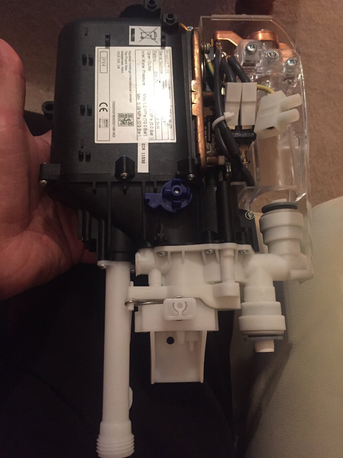

Hi, I am getting no hot water from a gainsborough 9.5 electric shower in a flat, I tested it in another flat with a seperate water supply and it works fine there !
Im thinking that points to low water pressure ?
is that correct ?
thanks

What is the model / name of the Gainsborough shower ?
When shower is run on cold only ,to give maximum flow ,what is the flow like at shower head ,should be quite a strong flow ?
I suspect it's an electric supply issue ,do you have a multimeter?
Hi, its 9.5kw I think the model is “e”
I have tested there is power to the shower, although the isolator switch feels a bit dodgy.
Measuring the voltage between live and neutral at the showers terminal block what was the voltage reading?
To be honest I only used a pen type voltage detector to check it was live, Ill get a multimeter tomorrow, I assume I should get 220-240 v ?
thanks
Unfortunately they do not tell you if the neutral is ok ,or what the voltage actually is. Yes use a multimeter.
By the way Have no idea what that model is ,pic isn't clear.
Yes 230/240 volts is what you should get.
Also I noticed the plunger stays down on the other flat
but in that one plunger goes down cold when switched on stays down when turned to hot (but no hot water) then comes back up when turned to cold again
