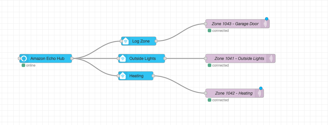

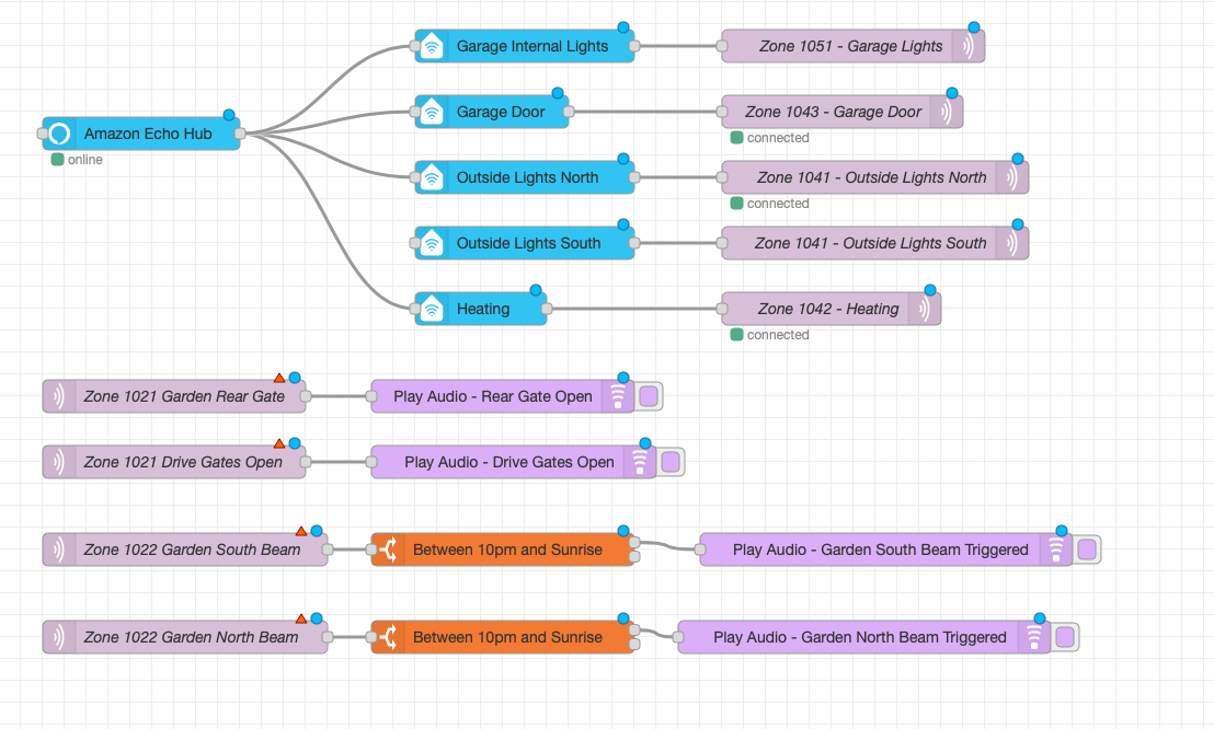

:) Yes, I know it sounds daunting. As long as you have a process to follow, then you should be able to keep things minimal and manageable. I don't think it's a good idea for the panel manufacturers to take on adding some of these procedural capabilities into their panels. It's fine with a simple output change and timer, but users tend to find that's never enough as they want to implement specific routines. Take your example of wanting to implement a chime, but for it not to become annoying, so to have a back-off period after triggering. Sounds simple, but is quite specific to your situation.
Some of the new tools like node-red make the routine stuff really simple to implement. Dragging and dropping nodes and connecting them up... I certainly wouldn't be scared, but you do want a robust reliable install which is more the hardware side.

That looks extemely cool- thank you- I'll have a read through, and stay calm!
