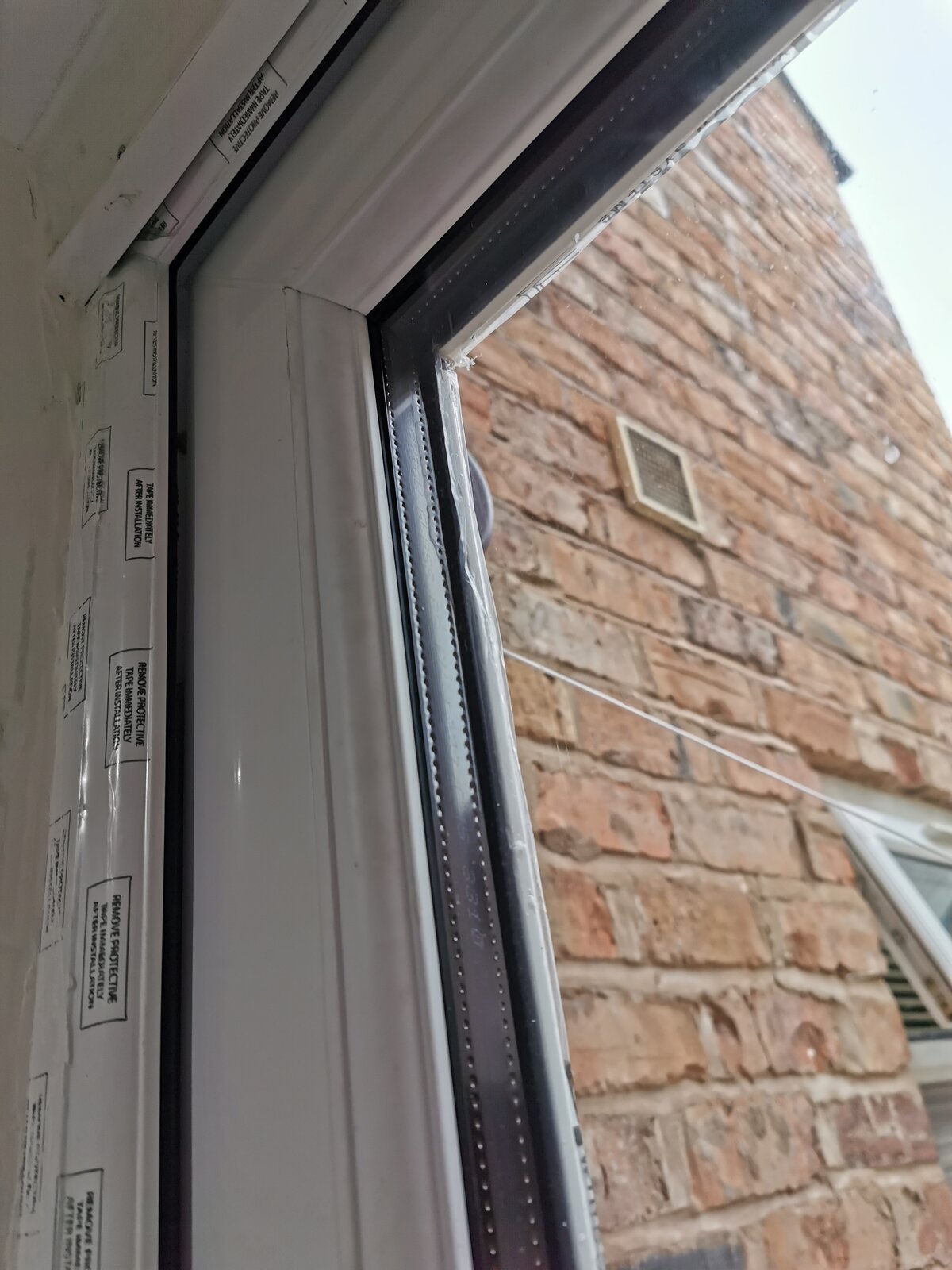

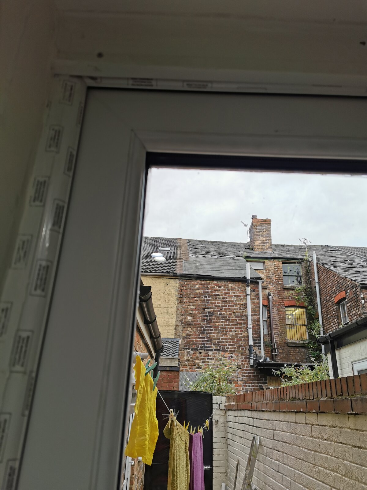

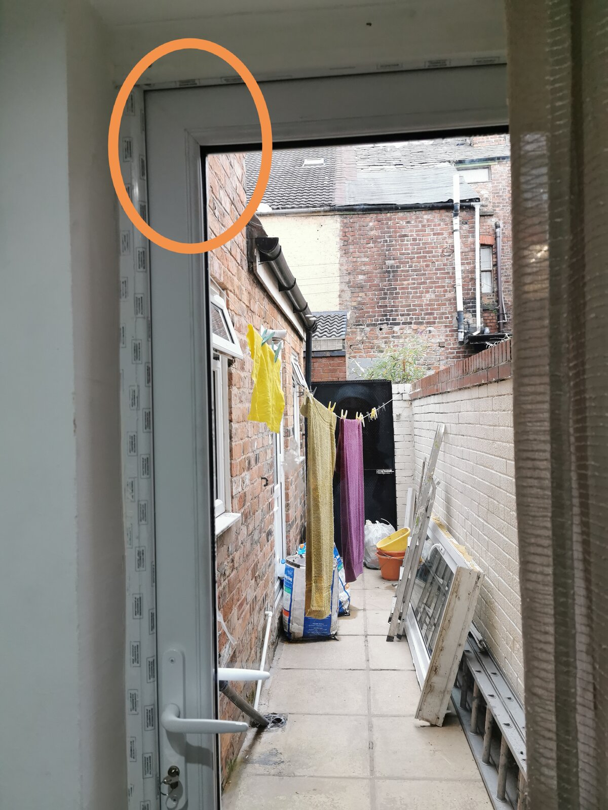

Just had a new door installed, the guy who fitted the door was not a professional door fitte, found there is a gap on the top left corner (handle side), when the door is locked the gap closes but still a debit card would slide in.
Changed the old door because of draught issue and it seems will have the same problem again in winter.
Need a solution please?
Hinge type is flag hinges.

Flag hinges won't help, they only adjust the hinge side for in and out adjustments, get non professional door fitter back to rectify, also buy him a new tape measure, the one he currently uses must have a couple of inches missing at the beginning

Hi. First thing is to see how much the door and frame are out of alignment. Close the door to point where inside of door is lined up with outside of frame.. you'll have to stand a foot to right and at angle that you can see gap well. Bottom will line up first. The gap at top may be more than your picture..you'll need someone to unscrew and unseal the frame at top and strike side. Leave bottom and hinge side alone. Adjust frame to align with door properly. Anchor frame to wall - not the same holes.

just remember full compression isn't achieved until the full locking mechanism is engaged.............
