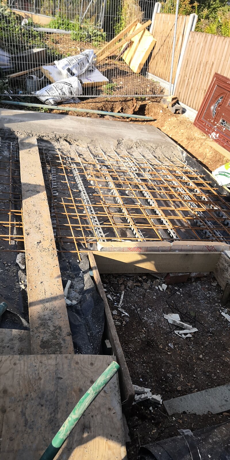

With a mixer by hand I guess he means. I've done several slabs on my own in a day of 2 ton. But that doesn't go far a strip foundation for a 20x 10 greenhouse or half a garage slab.
