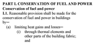

Why not? The new elements just need to comply with the following legislation.
How you do that is then open to debate. The minimum U-values in Section 5, Table 2 are only guides as to what is likely to pass the relevant SAP calculation, it's just more work to demonstrate compliance, but it avoids having to re-build the wall.
