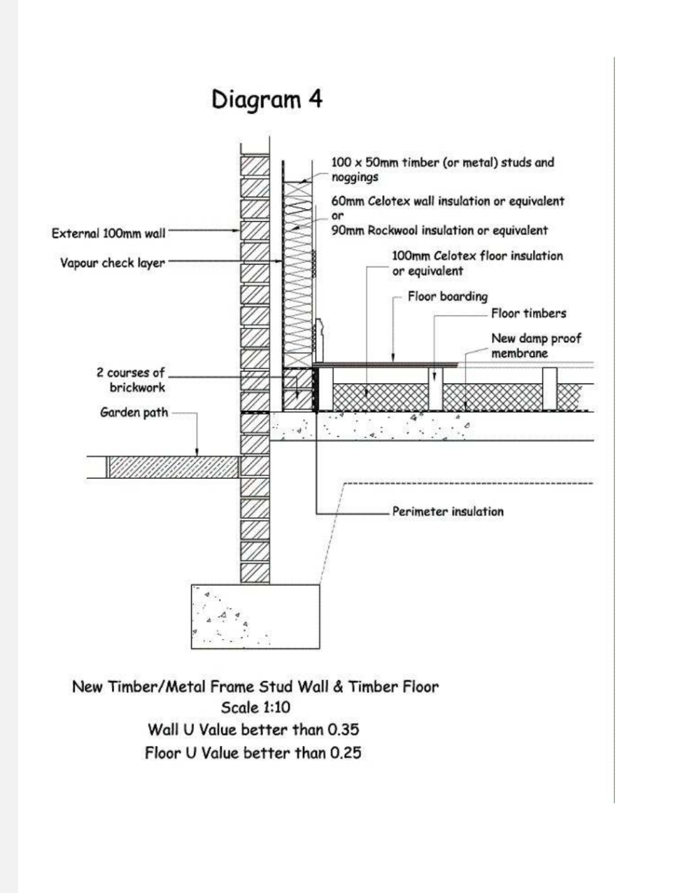

You want a minimum of 120mm pir in wall so min is 100 in 20 over or 60 /60
That's why I am planning to use PIR sheeting over the front of stud wall - would this not address that issue
Yes it would.

it's crazy how much variation there is - the image I posted was addressing goncg69's comment that Rockwool can't be used in stud walls.
The image was from LABC's own website for garage conversion guidance.
I do appreciate the replies. Do you concur with goncg69 about the rockwool or is it a non issue? What do you think about my vDPM amendment I posted about
There are many ways to conform the building regs. Your inspector has given you one and that drawing may well be another.

I'm not sure the thickness of PIR since the June update, but it used to be 60mm Celotex. However, whilst that passed regs it was only if it was continuous (not in between studs) and that did not allow for any services cut int to the wall. So a better target was to thicken the whole insulation to allow for services (80mm) or calculate how much should go between studs and then across the inner face.
Gonch mentioned 100 between and 20 over, but that was the pre-June spec for extensions (actually just 100mm between complied), and garages could be less. Again, I'm referring to pre-June so you would need to check what is required now - it may be much more onerous. Gonch may be correct regarding using Knauf quilt - that is for masonry walls with an inner skin of thermal blocks - which you won't have here, and it comes down to whether the 20mm of PIR is equivalent to the 100 or 120mm of thermal blocks. But either way, 20mm of PIR over a stud is not very good.
If you are not going to go with your inspectors' recommendations, then you need to propose a suitable detail and let them agree it. If you work on the principles above, then it can't be rejected.
