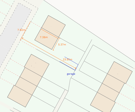

We are thinking of getting a new garage built as shed won't be any good for storing electric tools etc since it stays humid leading to rust.
We have a shed on its last legs on the side of the property at the end of driveway. Instead of building a garage there. Thinking of getting rid of it.
- Can I build right at the at the end(plan attached) of the plot? so that side and rear wall of garage is at border of plot?
I have added sketch plan to give better idea. Would be contacting planning department in council, but thought would get view from experts in here. Thanks
-Property not in conservation area, and in derbyshire if that helps.

You can build right up to boundary. It'll limit your roof height to 2.5m if you want to do it without planning but that's ok for a garage. Just need to check your house has permitted development rights then look at the requirements for building under permitted development. Other than the height it's pretty easy to do.

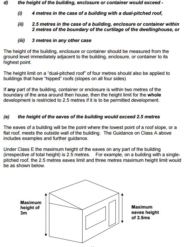

OK - Had a look at the document and can't work out whether if within 2m of a boundary, the max height can be 2.5m or is that eaves height? If so what's the total roof height?
If 2.5m max height, that's a flat roof only in reality.....
Both. See attached. (d) (ii) height of building limited to 2.5m; (e) height of eaves limited to 2.5m.
2.5m is the max height of the eaves of any building. As well as that if you are within 2m of a boundary then the overall max height is 2.5m so as you say petty much flat roof only.
