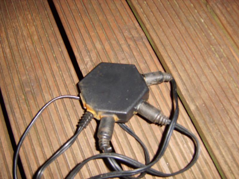

We have 3 rows of led lights in our decking, each row has its own cable and fits into one of those black hexagonal power terminals which in turn has a black transformer/plug.

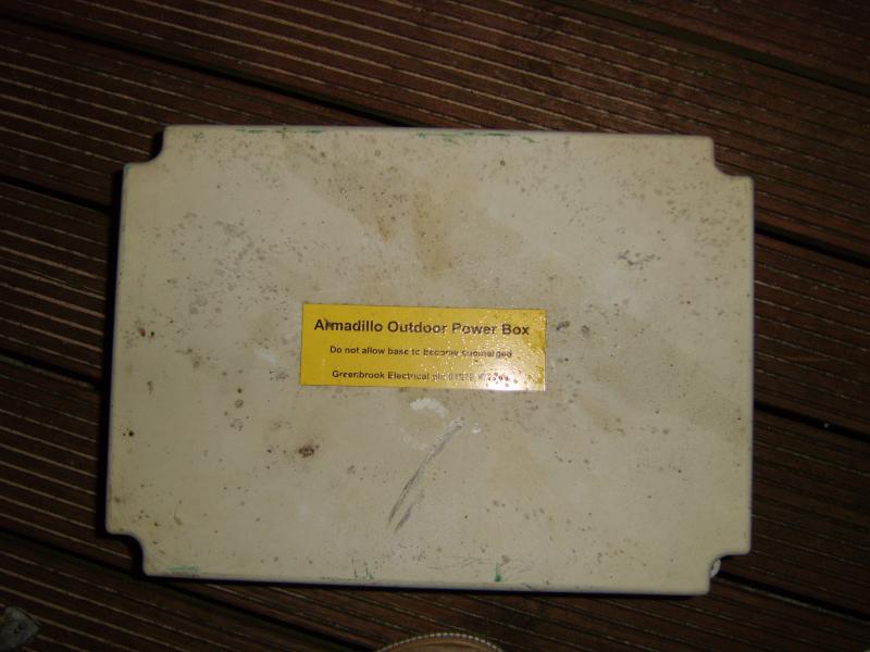

It appears that none of these plugs are weatherproof so what the previous owner has done is plug them all into a 4 way extension cable and house that cable in a freestanding weatherproof box. This allows all the lighting to be plugged into 1 of the wall sockets.
The weatherproof box obviously isnt waterproof as it was full of water! All the plugs are wet and rusty and slimey.

Or, it may be the free standing weather proof box was upside down, (you did not say in your original post) or it may not even be a weather proof box.
a picture or two would say more.
how to post a picture is in forum information
the weatherproof box just had some degraded mastic where the cables came in/out and water must have got in there. it says 'weatherproof' on the box. im guessing there should have been some device where the wires enter and exit to prevent water getting in?
so is the end bit of the cable from the leds in my decking that plugs into the power supply weatherproof? im just trying to work out how i can leave the cables out year round. what do people do that have fairy lights in their garden? surely they dont bring them in every night? our garden in quite big so if i wanted fairy lights on a tree at the end of the garden how would the electrics work for that?
an electrician has suggested hard-wiring (?) the lights into a box on the external wall next to the outdoor sockets, the box would have a switch so i could turn the lights on/off from there. could i do the same with the leds?
ive attached a couple of pics
you could do as suggested with the leds...............
how ever from what you have said so far it sounds like the power supply for the LEDS has corroded. Now we can see the hexagonal thing i would say its just a distribution box, or is it these that have coroded?
I would opt to have a new weatherproof box from TLC (SM WP401) other supplies of weather proof boxes are available.
There are thousands if not millions of these boxes in use with no water inside (I adapt another brand of box and have never had problems) so I would suggest the original one had water because
1) The lid / seals were not in place or tight
2) The box was lower than the cables*
When installing any external enclosure outside the main body should cover the cable or the cable should enter from below, and or have a drip loop.
