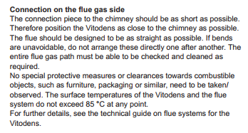

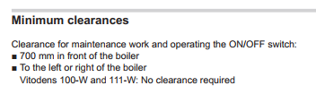

Looking at this, it looks like I could cover it on all sides?

and new boilers do not need air for cooling which is why you go by minimum dimensions which allows for servicing etc (y)
Jus for reference, Viessmann got back to me and said:
"5mm either side of the boiler, 150mm below and 250mm above the boiler.
With the cupboard door open 700mm in front of the boiler."
