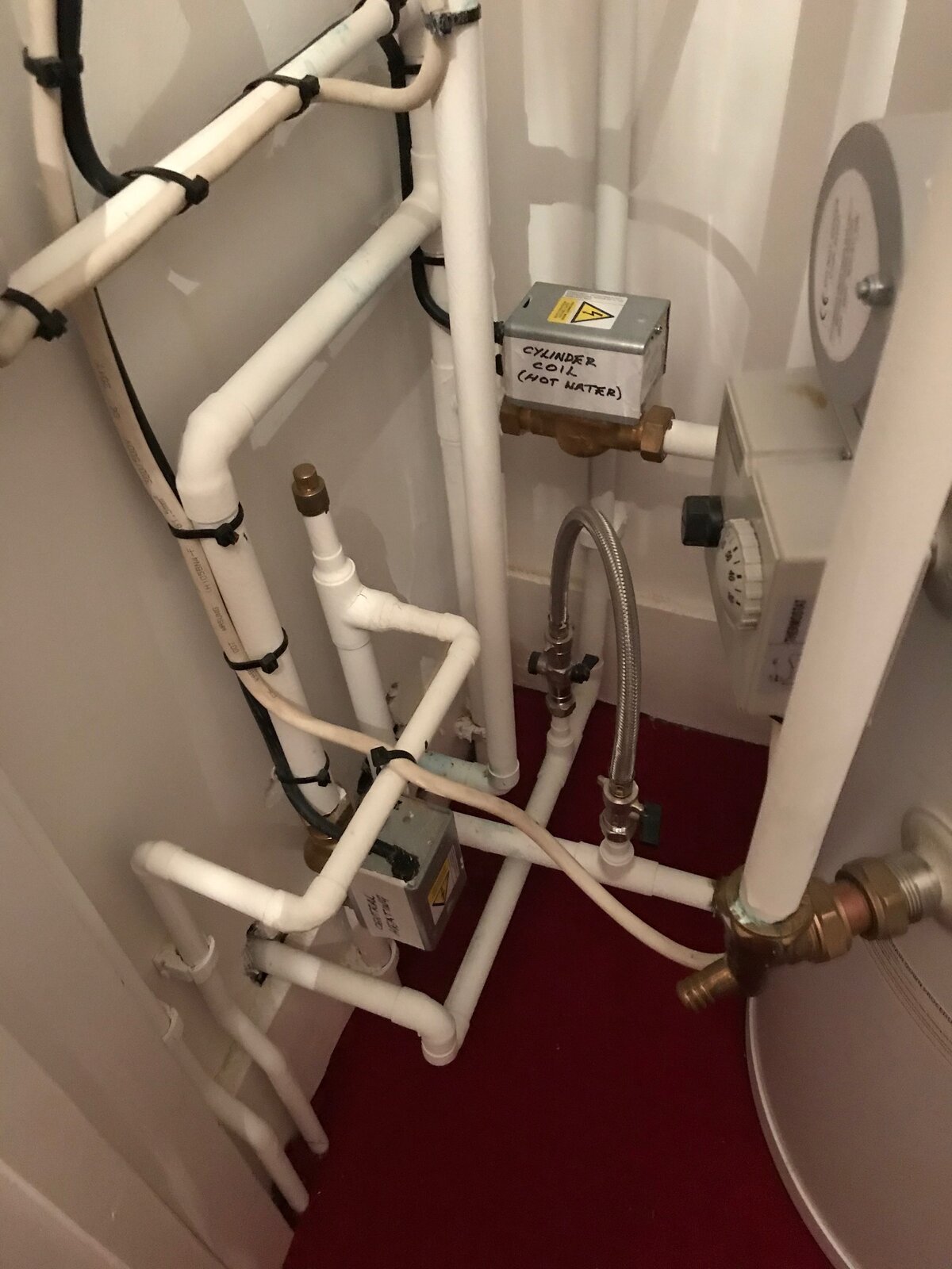

Cylinder thermostat is on side of cylinder. The cylinder has a lengthy warranty which I guess can be used if the thermo is at fault.

It does seem that when the water is warm/hot in the tank then the HW valve works. In the morning for example, the water is hot after being heated in the evening and the valve always comes on.
Post a photo of cylinder thermostat and zone valves. Also what temperature is the thermostat set to?
Temperature is set to 60C. Just noticed valve has now powered off, lever no longer floppy.
Valve will close automatically once cylinder has reached temperature so will close off again on its own after its warm. With unvented cylinders having high levels of insulation its not uncommon for folk to just run them on constant and that way the boiler will top up the heat in it as required but doesnt address the fault if yours is cold when it should be heating. could be simply a loose wire somewhere
