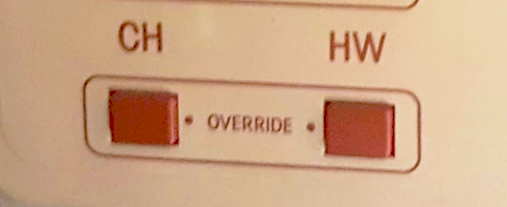

Have you checked that the 'Override' switch on the controller (post #6, pic 5) hasn't been set to (or is stuck in) the override position?
If it was there would be an on indication on the LCD display
I don't speak Potterton, and I find their control markings ambiguous. Is either switch in the pic below set in the 'override' position?
