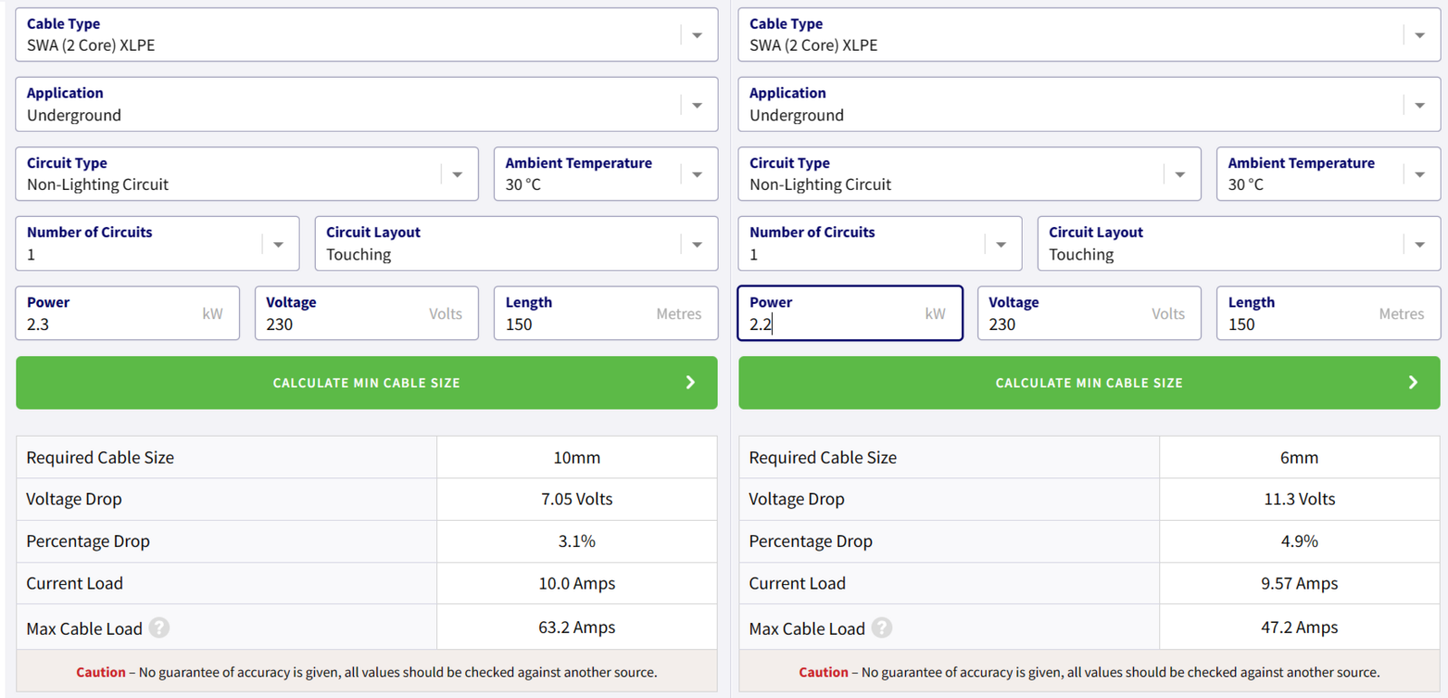

Currently have a 2.2Kw generator running a borehole pump of unknown wattage... but runs fine, pumps water into storage tank.
Need to move the location of the generator to new location, will be around 125-150m away from the pump, so will need to change the wiring etc.
Will be running armour cable to the generator with the appropriate connectors. (unless someone has a better idea)
Will voltage drop be an issue?
You need to specify the wattage or current of the pump, plus whether it is single phase or 3 phase. From those details, someone might be able to determine a suitable size of cable needed.
Well, if we calculate for the worst case....
The generator can only produce 2.2kw so the load can't be more than that, or the generator would be noticeably unhappy*. A generator that small will almost certainly be single phase. With a distance of 150m and using SWA cable buried in the ground, TLCs online calculator suggests a 6mm2 cable would give a acceptable voltage drop of 4.9%.
In reality, the load could be much less of course. If you can't find the wattage of your pump, look online for one of a similar spec in terms of flow rate and head to get a rough idea. The submersible pumps on sale at Machine Mart for instance, seem to range from about 250w up to about 1500w
*Edit to add: In fact, the pump must be significantly less than 2.2kw running, otherwise the startup would be a problem. I know from experience that starting a 2kw jetwash can stall the engine on my 2.8kw generator.
Which will cost you around £500. For that sum you could build a sound-proof enclosure several times over
My gut feeling from experience started at 10mm². for 2.2KW @ 150m
First on-line calculator surprised with 4mm² & 4.9%, next couple gave 6mm² & TLC gave me 4.9%
I have never compared different sites before but the difference is a little worrying.

FWIW TLC give 10mm² at 2.3KW
