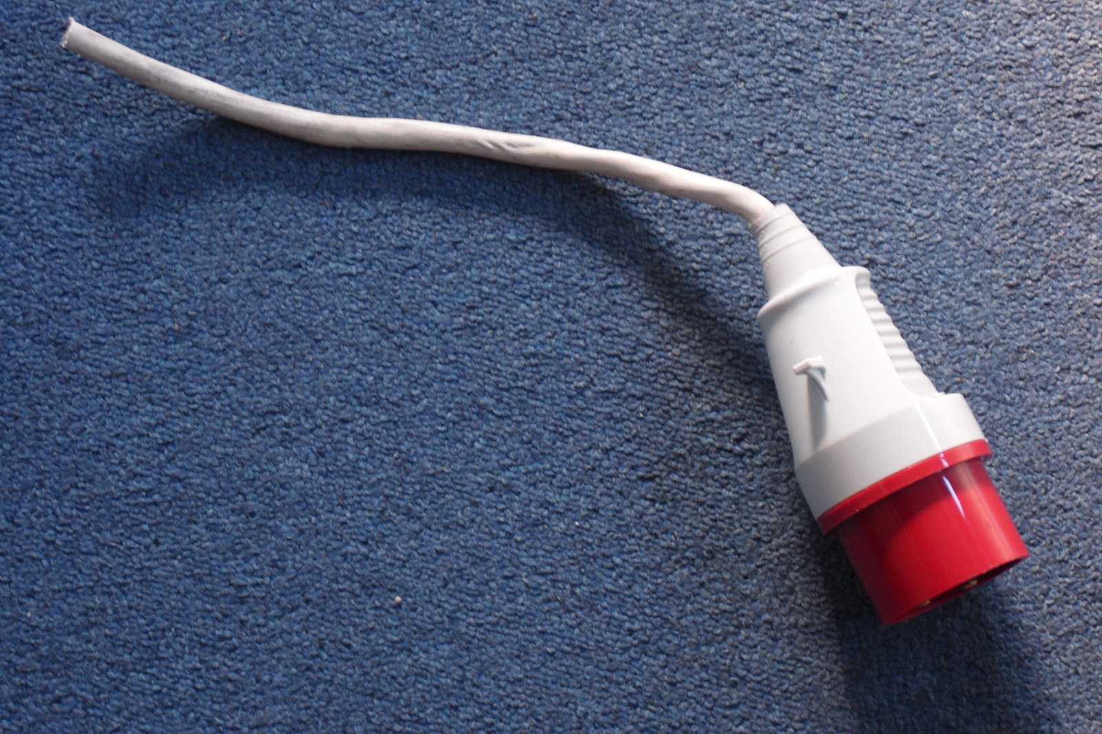

Well if it's any consolation I have come across a selection of 'widow makers' over the years which have been made by fully qualified electricians.
Such as this:
Removed from the 'load' end of a catering trailer.
For infothis was a 16/3 using 3 pins for a 1ph with 2.5mm² flex, other end was a 32/1 and usually used on a 5.5KVA genset. I measured the load at 55A IIRC, hence the heat damage.
This particular wagon had asked for 32/1 and the cable was laid in for them prior to their arrival. They turned up, hooked up, went looking for the MCB and flicked it on. They soon came looking to complain there was something wrong.
And to clarify this was removed from the wagon end of the cable, so part of a widowmaker. Note the heat damage.
