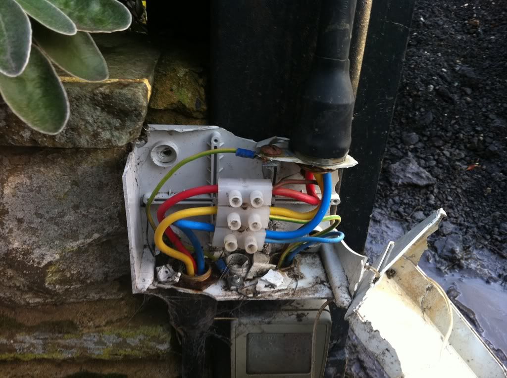

Aparrently it has been like that for a couple of months. He said the RCD has never tripped either.
Open like that likely will run for years. But with less damage just a few cracks then fills up with dust and water and very quickly theirs a problem.
Saw one that had been damaged like that and the guy had just put gaffer tape on it and filled it with expanding foam. It lasted for years that way.
Why is there an earth cable going into a terminal block with a phase cable? Or is that a single phase installation wired with 3 phase wire with one phase used as earth?
There isn't.
No.
It's a single phase cable with Red, Yellow and Blue cores. If you connect a phase to earth you get a lot of excitement for a very short time.
Although it is obvious, the yellow core should be sleeved G/Y, and the blue should be sleeved black.

With that picture in mind, will those who use the harmonised black as neutral rather than harmonised grey please stop?
I bet 100% of them used to use the old blue as the neutral, so why use the new black?
Yes as in some cases you do not need a neutral for a balanced 3 phase load so a 3 core in either colour scheme is acceptable as long as there is provision of an earth.
