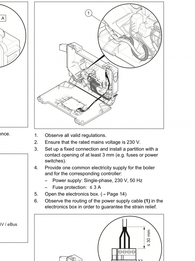

Sorry I haven't explained it properly, we have always had what looks like a blank electric socket where the wires from the controller run, and then in turn into the boiler, there are lots of wires in the airing cupboard to feed pump, valve etc. The only thing that is different now is we also have another wire/lead going into a nearby socket to provide a permanent live, which he said boilers now need , according to the manual which I am assuming he has followed, these are wired into the same block on the pcb, the part I'm confused with is what does the manual mean by a common supply, is this what he has done? I am assuming he has done it correct but as I said, he was a plumber not an electrician so I'm not 100% confident
would be easier for everyone if you had some pictures of the install/ wiring
These are the manual diagrams. The first shows the main electric supply

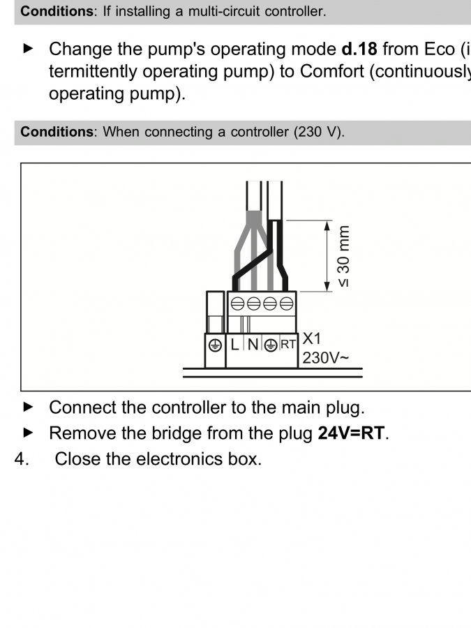

This shows the wiring for the controller wires coming from the 'blank' which is only live when the controller is on.

no the picture of your installation of what he has done as you've already accessed the pcb
Really, all I'm asking, is it correct that the permanent live in the first picture is running to a plug in a normal wall socket?
Post a picture of what the plumber has done and we'll go from there..
I haven't accesssed anything, I just know he wired into the old 'blank' from the old boiler, and I now also have a lead into a socket which I never had before with my old Baxi non condensing boiler
It appears that more than one isolater has been used to isolate CH controls.
He has wired the live, neutral and earth from a socket into the main pcb, and then wired the controller (2 channel programmer) feed into the same block on the pcb, does anyone know if this is correct as the manual states 'provide one common supply for the boiler and the corresponding controller?
