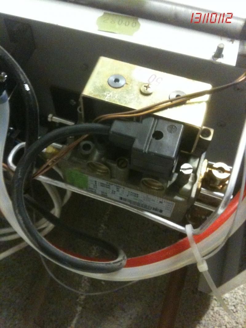

Check the pilot solenoid valve on the boiler.
Also check for good continuity on the ht lead

is the solenoid valve the item with the black lead/4 pin square plug on the end which is integral to the main gas v/v? Does it have two coils one for open & other for close? see attached photo
